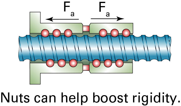

The default method for increasing ball screw rigidity is to increase the preload of the ball nut. ball screw rigidityHowever, the ball nut is one of the most rigid components in the ball screw assembly, so increasing ball nut rigidity has little effect on the overall system rigidity (except when upgrading from a ball nut with no preload to one that is preloaded). Also, higher preload causes higher frictional torque, which means more heat is generated and more torque is required to drive the screw. A double ball nut is somewhat more rigid than a single nut, but again, the effect is minimal due to the nut’s already high rigidity relative to the other components.
The limiting factor for rigidity in a ball screw assembly is typically the screw shaft. The rigidity of the screw shaft depends on its modulus of elasticity, diameter (which determines its cross-sectional area), and unsupported length.
The screw’s modulus of elasticity is dependent on the material (typically steel), and its diameter is primarily determined by the required thrust force and speed. The unsupported length of the screw shaft is determined by the stroke and the end bearing arrangement.
A double ball nut has higher rigidity than a single nut, but the overall effect on the ball screw system’s rigidity is relatively small.

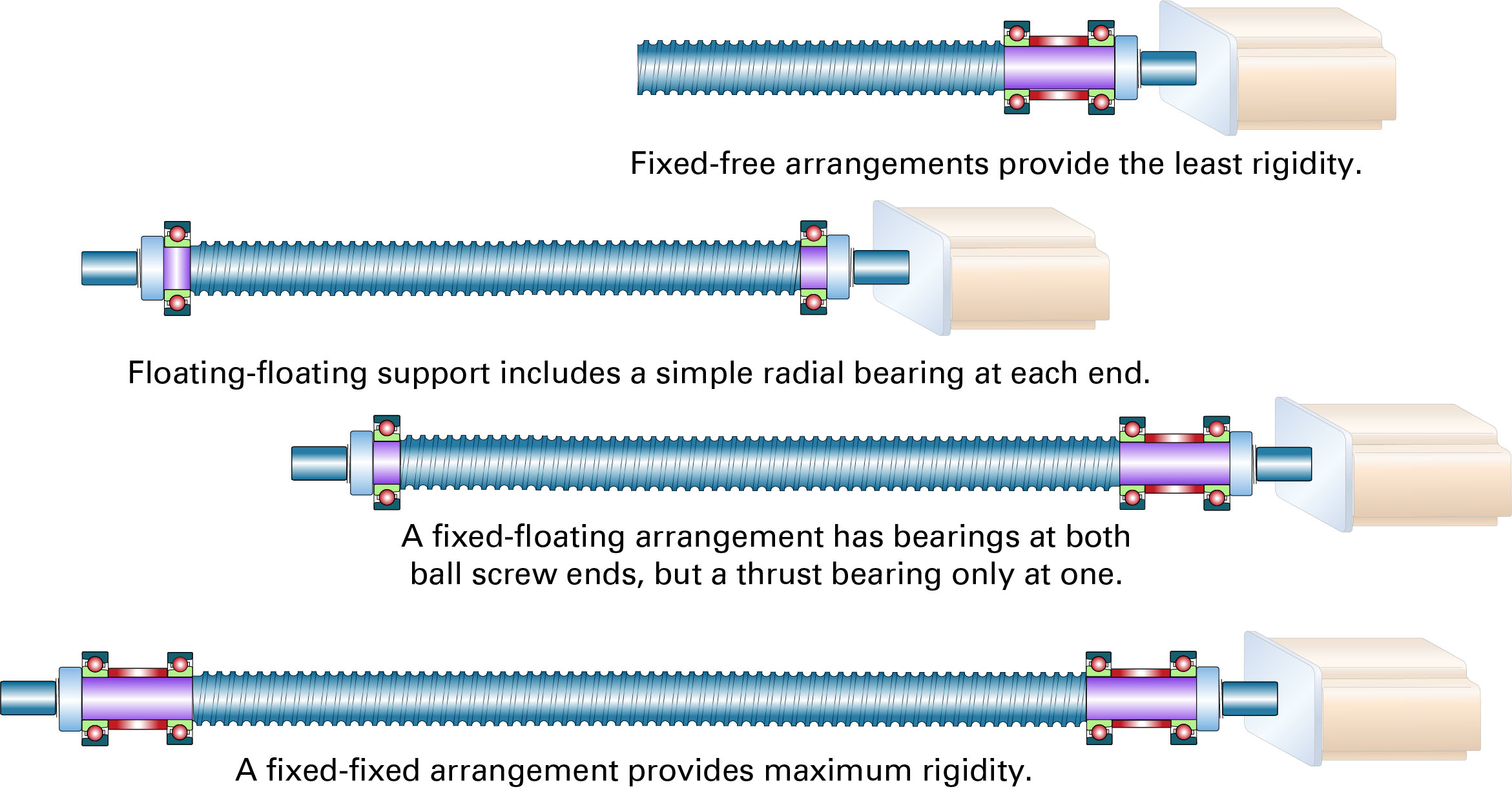

While the screw’s material and diameter are generally set by the application, the end bearing arrangement (and hence, its influence on unsupported length) is chosen based on factors such as speed, buckling load, and rigidity.
ball screw rigidityThere are four common end bearing combinations for ball screw assemblies. From most to least rigid, they are: fixed-fixed, fixed-floating, floating-floating, and fixed-free.
A fixed end uses an angular contact thrust bearing, for support against both radial and axial loads, while a floating end uses a simple radial bearing, with no support for axial loads.
A free end has no bearing support.
Using the stiffest bearing arrangement – fixed-fixed – increases the rigidity of the screw shaft by four times compared to the least rigid arrangement of fixed-free. This is due to two design advantages.
The fixed-fixed end bearing arrangement provides the highest rigidity, while fixed-free is the least rigid arrangement.

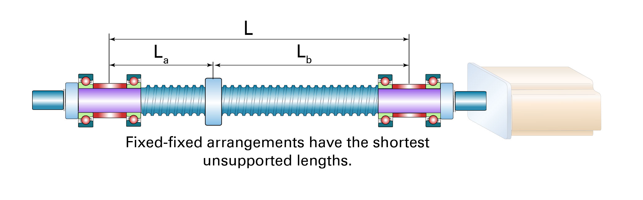

First, using angular thrust bearings on both ends allows forces to be transmitted through the screw on both sides of the ball nut. ball screw rigidity

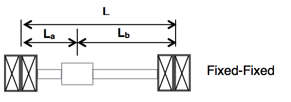

In addition, with thrust bearings on both ends, the maximum distance between the ball nut and either one of the fixed bearings occurs when the nut is at the middle of the stroke, which means the unsupported length is one-half the length of the screw.
In a fixed-fixed end bearing arrangement, the maximum unsupported length is 1/2 the length of the screw (La=Lb).
