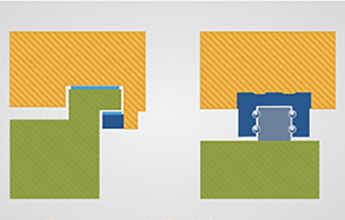

Friction is the enemy of a cleanroom
The overarching goal when using a linear motion system in a cleanroom application is to keep its particle generation to a minimum. But linear motion components rely on sliding or rolling motions, which necessarily produce particles due to friction and wear between surfaces. So one of the main areas of focus should be to reduce friction as much as possible.
boxway
Plain bearings (left) rely on sliding contact, which typically exhibits higher friction and higher particle generation than the rolling contact found in recirculating bearings (right).
Image credit: Poyakar Co.
This means choosing rolling over sliding contact — making linear ball bearings and ball screws a better choice than plain bearings and lead screws for most cleanroom applications.
