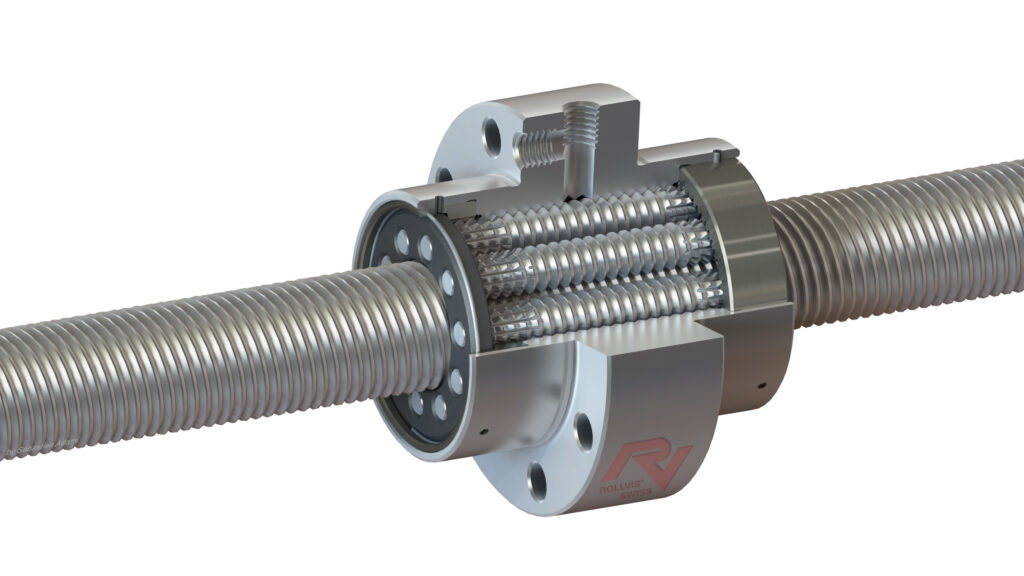

Roller screw shafts come in a variety of diameters and load capacities. Some are 3.5 mm in diameter with a 500-lb load capacity, while others can be 120 mm with a 500,000-lb capacity — enough to lift the Statue of Liberty. Regardless of size, roller screw systems perform well in high-force applications and simplify integration, setup, operation, and maintenance compared to complex hydraulic systems.

Miniature roller-screw image source: Rollvis
