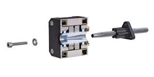

The basis of a hybrid actuator is a hollow shaft motor. Instead of the common motor design, which includes a simple drive shaft running through the center of the rotor, the screw shaft or the screw nut is mounted inside the rotor. When the screw shaft is mounted inside the rotor, the configuration is sometimes referred to as a driven screw assembly, and when the screw nut is mounted inside the rotor, the configuration is commonly referred to as a driven nut assembly.
The driven screw configuration is most similar to a traditional screw assembly in terms of end fixity, where one end of the screw is supported by one or two axial bearings and coupled to the motor, while the opposite end is either “free” (not supported) or supported by one or two axial bearings. The difference in a driven screw hybrid actuator is that the driven end of the screw is mounted directly into the rotor of the motor and is supported by bearings inside the rotor. No external bearings or screw-to-motor coupling are needed. Like a traditional screw assembly, the nut is mounted external to the motor, and the rotation of the screw moves the nut along the screw shaft.
hybrid actuators
Cutaway of a hybrid actuator with a driven screw from Thomson Industries.

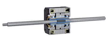

In the driven nut configuration, movement can occur in one of two ways: the nut/motor combination can be constrained so that the screw shaft travels back-and-forth as the motor rotates the nut; or the screw shaft can be constrained so that the motor/nut assembly moves along the stationary screw. When the screw shaft is constrained and not allowed to rotate, higher speeds can typically be achieved, since “whipping” (the jump-rope type effect that occurs when a screw is turned very rapidly) is avoided. An axial bearing is typically mounted on the outer circumference of the screw nut (inside the motor rotor) in order to take up thrust forces.
hybrid actuators
Cutaway of a hybrid actuator with a driven nut from Thomson Industries.
