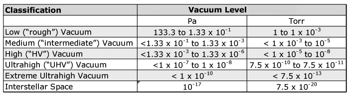

Technically, any environment with a pressure less than atmospheric pressure (101,325 Pa or 760 Torr) is considered a vacuum, but vacuum levels are often broken down into these five categories:
vacuum applications

Units of measure for vacuum include inches of mercury (in. Hg), millimeters of mercury (mm Hg), atmosphere (atm), and micron (μ, where 1 μ  = 0.001 Torr). The most common units for specifying vacuum levels in industrial applications are:
  • Torr, which is used primarily in the U.S. (1 Torr = 1 mm Hg)
  • Pascal, which is the SI unit (1 Pa = 1 N/m2)
  • millibar (1 mbar = 0.001 bar; 1 mbar = 100 Pa)
