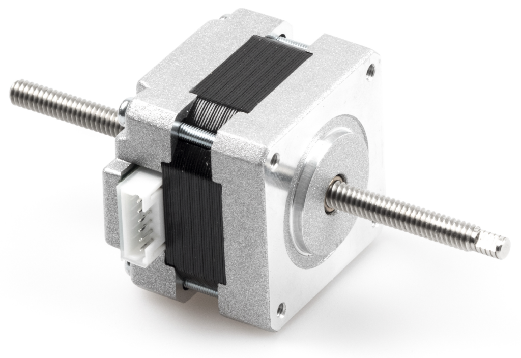

Semiconductor manufacture and assembly are just a couple NEMA stepper actuator applications.
Sometimes called motorized screws or motorized leadscrews, NEMA stepper-motor linear actuators can reliably hold a load against an external force — even under open-loop control.

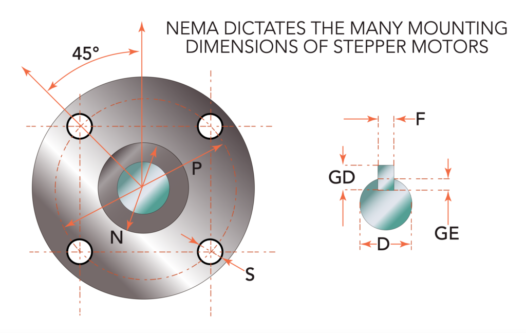

Stepper motors generally adhere to the NEMA ICS 16-2001 standard for frame sizes, which specifies mounting dimensions such as flange size and bolt circle diameter. However, one dimension not covered by the NEMA standard is motor length. And this flexibility in motor length for a given frame size provides manufacturers with another option for increasing the torque production of a particular NEMA size stepper motor — by creating motors with longer stack lengths. For example, double- and triple-stack stepper motors are now common offerings from several manufacturers.
