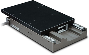

ironless linear motors
High-precision positioning stages often incorporate an ironless linear motor, profiled guide rails, and an optical encoder.
Image credit: Primatics Inc.
