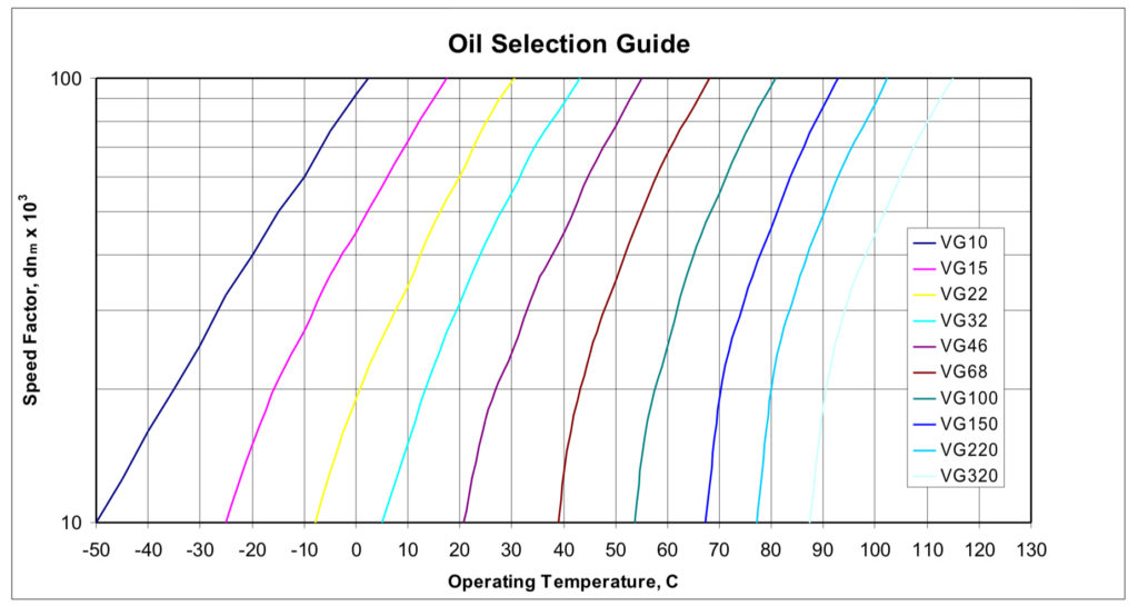

When using oil for ball screw lubrication, it’s important to use the right viscosity oil in the proper amount. If the oil viscosity is too high, or if there’s too much oil, excessive heat can be generated. On the other hand, if the oil viscosity is too low, or if there’s not enough oil lubrication, the screw will experience additional friction and wear will be accelerated. The proper oil viscosity is based on the screw’s average speed, diameter, and operating temperature. If the applied load is high – typically greater than 15 to 20 percent of the dynamic load capacity – manufacturers often recommend using oil with extreme pressure (EP) additives for extra protection against wear.
