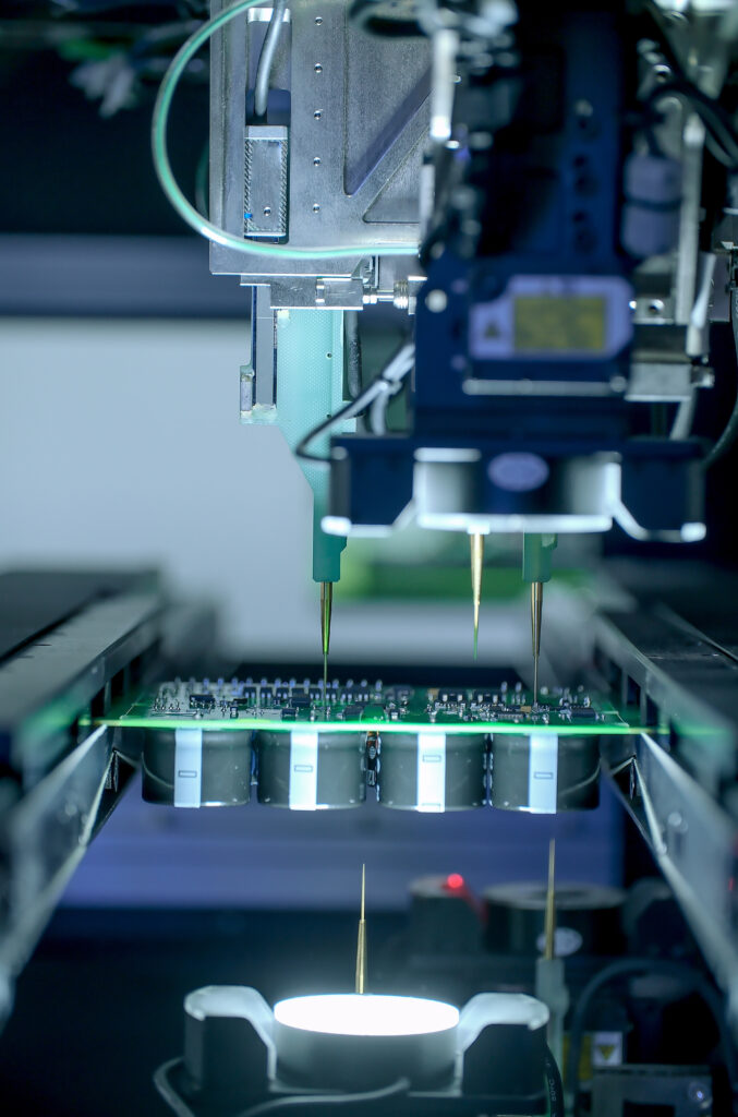

In this semiconductor-assembly application, a miniature vertical axis features a tiny linear drive complete with Renishaw feedback. Image: Adobe Stock

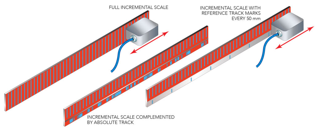

Here’s one version of distance-coded encoder reference marks, where the even-numbered reference marks shift by one grating period, and any two consecutive reference marks that are detected let machine controls calculate where the reader head is along the encoder scale upon startup. To provide absolute position measurement, magnetic encoders typically employ two magnetic tracks on the same scale — an incremental track and an absolute track.
Absolute track coding essentially provides the read head with a unique pattern for every position. The read head contains two sensors — one for each track. One setup uses a Hall sensor to read the absolute track … and a magnetostrictive sensor to read the incremental track. On startup, the encoder reads the absolute track to determine its position … and then during movement, it reads the incremental track for position tracking and measurement.

One advantage of magnetic linear encoders is the way in which magnetic tape can be supplied in very long lengths. In fact, real-world application examples include magnetic scales upwards of 50 meters long. But for incremental encoding, this means the homing sequence to a single reference mark could require traversing the entire length of the encoder. Therefore, magnetic linear encoders often include distance-coded reference marks. These extra marks are magnetic poles on the scale in addition to the standard magnetic poles. The reference marks are individually spaced — in other words, in a distinctive irregular pattern along the length of the tape that’s independent of the standard magnetic poles.
After traversing two reference marks, linear encoders with such scales can report absolute position as well as the distance between the two marks and the direction of travel as well as the length of each magnetic pole and the basic increment — the distance between odd reference marks.

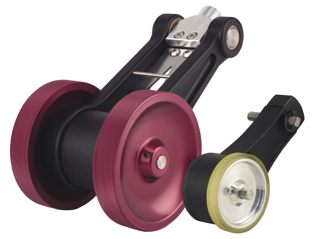

Linear-measurement solutions come in a variety of packages not covered in this article. Wheel options  suit a range of running surfaces. Shown here are Tru-Trac Models TR3 and TR1 — all-in-one linear-measurement solutions from Encoder Products Co.
