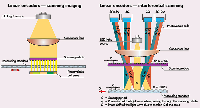

Many precision linear encoders work by optical or photoelectric scanning. In short, a read head tracks periodic graduations just a few micrometers wide and outputs signals with small signal periods. The measuring standard is usually glass or (for large measuring lengths) steel bearing periodic graduations—marks on the carrier substrate. It’s a contact-free mode of position tracking.
Used with incremental grating periods between 4 and 40 μm, PRC (absolute) code image-scanning linear encoders work with light-signal generation. Two gratings (on the scale and scanning reticle) move relative to each other. The scanning reticle’s material is transparent, but the scale’s material can be transparent or reflective. When the two pass each other, incident light modulates. If gaps in the gratings align, light passes through. If the lines of one grating coincide with gaps of the other, it blocks the light. Photovoltaic cells convert the variations in light intensity into electrical signals with a sinusoidal form.
modes-of-photoelectric-operation
Left: Image-scanning linear encoders work by light-signal generation. Right: Interferential encoders output signals that are largely free of harmonics and can be highly interpolated. That makes them useful for applications needing high resolution and accuracy.
Another option for graduations with grating periods of 8 μm and smaller is interferential scanning. This linear-encoder mode of operation leverages diffraction and light interference. A step grating serves as the measuring standard, complete with lines 0.2 μm high on a reflective surface. In front of that is a scanning reticle—transparent grating with a period that matches that of the scale. When a light wave passes through the reticle, it diffracts into three partial waves with -1, 0, and 1 orders of roughly equal intensity. The scale diffracts the waves so luminous intensity concentrates in diffraction orders 1 and -1. These waves meet again at the reticle’s phase grating where they diffract once more and interfere. This makes three waves that leave the scanning reticle at different angles. Photovoltaic cells then convert the alternating light intensity into electrical-signal output.
In interferential scanning, relative motion between reticle and scale causes the diffracted wave fronts to undergo a phase shift. When the grating moves by one period, the wave front of the first order moves one wavelength in the positive direction, and the wavelength of diffraction order -1 moves one wavelength in the negative. The two waves interfere with each other when exiting the grating, so shift relative to each other by two wavelengths (for two signal periods from a move of just one grating period).

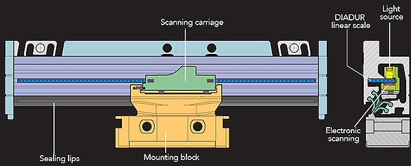

One challenge in linear encoder integration is that the devices operate right at the motion axis, so are exposed to the machine environment. For this reason, some linear encoders are sealed. An aluminum housing protects the scale, scanning carriage and its guideway from chips, dust and fluids, and downward-oriented elastic lips seal the housing. Here, the scanning carriage travels along the scale on a low-friction guide. A coupling connects the scanning carriage with the mounting block and compensates for misalignment between the scale and machine guideways. In most cases, lateral and axial offsets of ±0.2 to ±0.3 mm between the scale and mounting block are allowable.
Heidenhain-linear-encoders-side-view
This is a side view of a linear encoder. Some manufacturers use photolithographic processes to get precision graduations on the tape—for example, matte-etched lines on gold-plated steel tape with graduation periods of 40 μm; chromium lines on glass with a period of about 20 μm; three-dimensional chromium structures on glass with a graduation period of about 8 μm; and reflective 3D planar structures for graduation periods of 2 μm and finer.

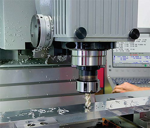

Case in point: Many parts from one blank
Consider an application in which a machine drills and then reams a 500-mm-long aluminum blank. Medium feed rates during these operations are low, so heat generation in the recirculating ballscrew is initially negligible. But the next production step is to mill contours, so feed rate spikes—causing considerable heat generation in the ballscrew.
If the milling machine runs in a semi-closed loop, recirculating ballscrew thermal expansion causes deviations between the drilling and milling pattern (in one actual case, deviations to 135 μm near loose bearings of the ballscrew). Closed-loop operation avoids these errors.
Refer to the illustrations of the machining application. Note how the functional dimension between the hole position and a bisecting workpiece line is 12 mm and must meet tolerance grade IT8 (which allows for deviation of ±13 μm). Deviations up to 135 μm occur in semi-closed-loop mode, which means the workpiece only complies with tolerance grade IT13 (and not the required tolerance grade IT8).
