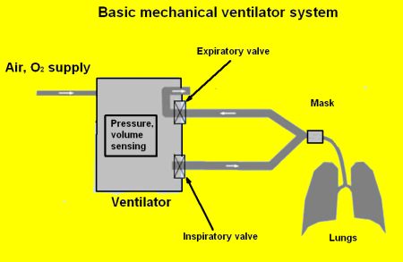

Ventilators are relatively simple devices, as explained by my colleague Lee Teschler in this post on our sister site, Test & Measurement Tips. They consist of around a dozen components: compressed air and oxygen tanks, connecting tubes, a set of valves (referred to as inspiratory and expiratory valves), a Y connection for connecting the tubes, sensors that monitor the air pressures and volumes through the breathing cycle, filters, a humidifier, and a ventilator mask for the patient.

voice coil actuators
Voice coil actuators control valves that deliver air to patients who can’t breathe on their own due to lung disease, surgery, or illness.
Image credit: Sensata Technologies
One benefit of voice coil actuators is that they’re relatively easy for manufacturers to customize to the exact application requirements, including the use of special materials for biocompatibility or other environmental requirements. They’re also available in either a moving coil design (better for acceleration) or a moving magnet design (better for heat dissipation). Regardless of the setup, they can be constructed with extremely small form factors. In fact, voice coil actuators as small as a thimble have been manufactured for some ventilator applications.
Voice coil technology also provides significantly better performance than solenoids — the traditional solution for valve control — in many respects. Their low moving mass gives them very high acceleration capabilities, and they provide precise, controllable, bi-directional motion, where solenoids are simply “on-off” devices and require a spring to provide bi-directional movements. And hysteresis in a voice coil actuator can be orders of magnitude lower than in a solenoid, meaning voice coils can provide much better repeatability. Of course, safety is also a significant concern in medical device applications. When voice coils are used to control air flow in ventilators, magnetic latches can be employed to ensure the actuator keeps valves open if power is lost, so the patient can continue to breathe on their own.
