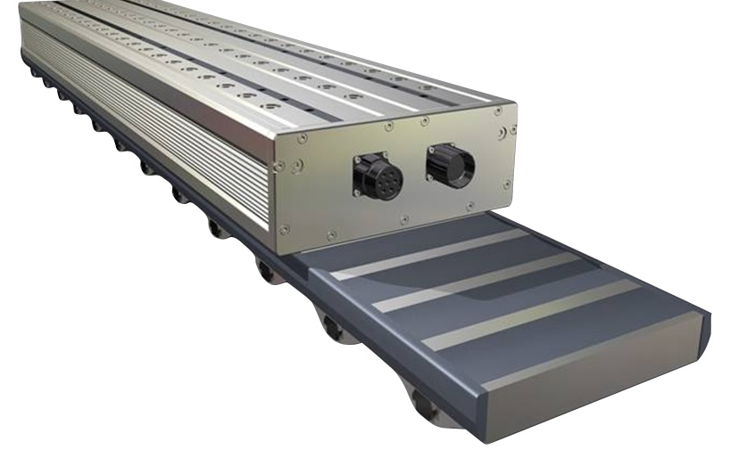

1FN6 magnet-free secondary: Suitable for long traverse lengths at high acceleration and velocity rates. Magnet free secondary and air convection cooled design. Can be used for horizontal, inclined or compensated vertical axes. Nominal Force (Fn) 2,110 N. Maximum Force (Fmax) 8,080 N. Maximum velocity 532 m/min. With air convection cooling.
Shown here is a 1FN6 linear motor.
