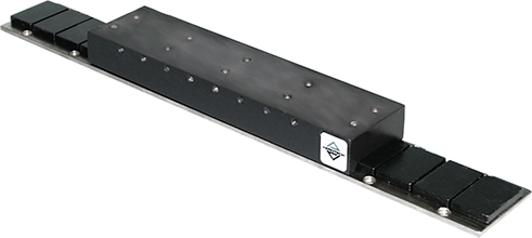

Ironcore linear motors
As their name suggests, ironcore linear motors are constructed with the coils of the primary wrapped around an iron core. The secondary part is typically a stationary, flat magnet track. Ironcore linear motors are characterized by their very high continuous force and ability to move large loads, which make them ideal for machine tool, injection molding, and pressing applications.
Ironcore Linear Motors
Image credit: Aerotech
One downside of ironcore linear motors is an effect known as cogging, which is caused by the magnetic pull of the secondary on the primary as it moves across the magnet track. This pull creates a detent force that degrades the motor’s smoothness of motion. Manufacturers have various ways of reducing the cogging effect, but this should be carefully considered in applications such as printing, where smoothness of motion is critical to the quality of the end product.

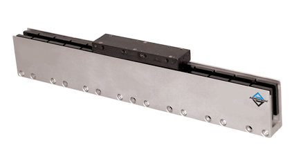

Ironless linear motors
Ironless linear motors eliminate iron from the primary by using coils embedded in an epoxy plate. This reduces mass and enables them to achieve highly dynamic motion. Where iron core linear motors consist of a flat magnet track, ironless linear motors typically consist of a U-shaped magnet track, with two plates of magnets facing each other. This reduces heat dissipation and means that ironless linear motors have lower thrust forces than iron core motors. But their lower mass (due to a lighter primary part) gives them better acceleration capabilities and short settling times, making them ideal for precise, rapid movements.
Ironless Linear Motors
U-Channel Ironless Linear Motor
Another benefit of ironless linear motors is that there are no attractive forces between the primary and secondary parts, since there is no iron in the primary. This makes them much easier and safer to assemble than ironcore linear motors. It also means that the supporting bearings do not have to be sized to accommodate the attractive forces, and will generally have a longer service life.
