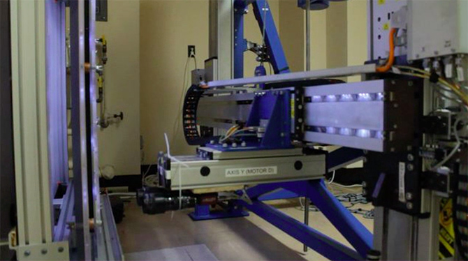

A robotic control XYZ gantry with linear-motor actuators from IntelLiDrives moves a pair of cameras between growing plant samples. Infrared light-emitting diodes behind the fixture provide illumination.

Image courtesy of University of Wisconsin-Madison Plant Imaging Center and IntelLiDrives

Linear-motor application example: Researchers use XYZ robot to develop hardier crops
Watching plants grow and develop roots can be tiresome, but tracking plant development reveals how genetically modified plants can give better yields than unaltered versions.
Now, plant-physiology researchers at the University of Wisconsin-Madison are using automated image acquisition to make that easier.
Researchers place plant samples in an LED-illuminated 6×6 grid of Petri plates on a vertical tubular aluminum frame to conduct 36 experiments in parallel. Then robotic camera CCD imagers working off an XYZ vertical gantry create time-lapse movies of plant growth to give researchers better understanding of how genetic manipulations affect development.
The XYZ gantry consists of computer-controlled linear actuators, each integrating a brushless linear servo motor from IntelLiDrives with a high-resolution linear encoder.
The gantry moves the CCD cameras over a 1-m-by-1-m area with positioning resolution of 10 µm.
An extra linear axis lets the researchers change the camera’s field of view to get well-focused images of the seedlings in their Petri plates.
The robotic camera snaps a picture every 30 seconds to capture the curling and twisting motion of germinating seeds putting out new roots.
After capture, the images go through analysis that determines cellular growth rates in the root as well as the angle and curvature of the root tip. Computer-vision algorithms study the camera’s time-lapse videos and measure (among other things) the sizes of seeds, plants’ cellular growth rates, and the angle and curvature of the roots.
Using this XYZ robot with computer vision gives researchers the ability to automate the plant growth time-lapsed image acquisition and processing … and increase throughput of experiments to track the plants growth and development. Now researchers can find the genes that control plant’s root growth and have fundamental importance to crop improvement. It lays the foundation for discoveries that could one day further improve plants for human consumption and other use.
linear motors at work
Robotic cameras and computerized motion control are helping researchers identify plant characteristics that improve hardiness. Image courtesy IntelLiDrives
