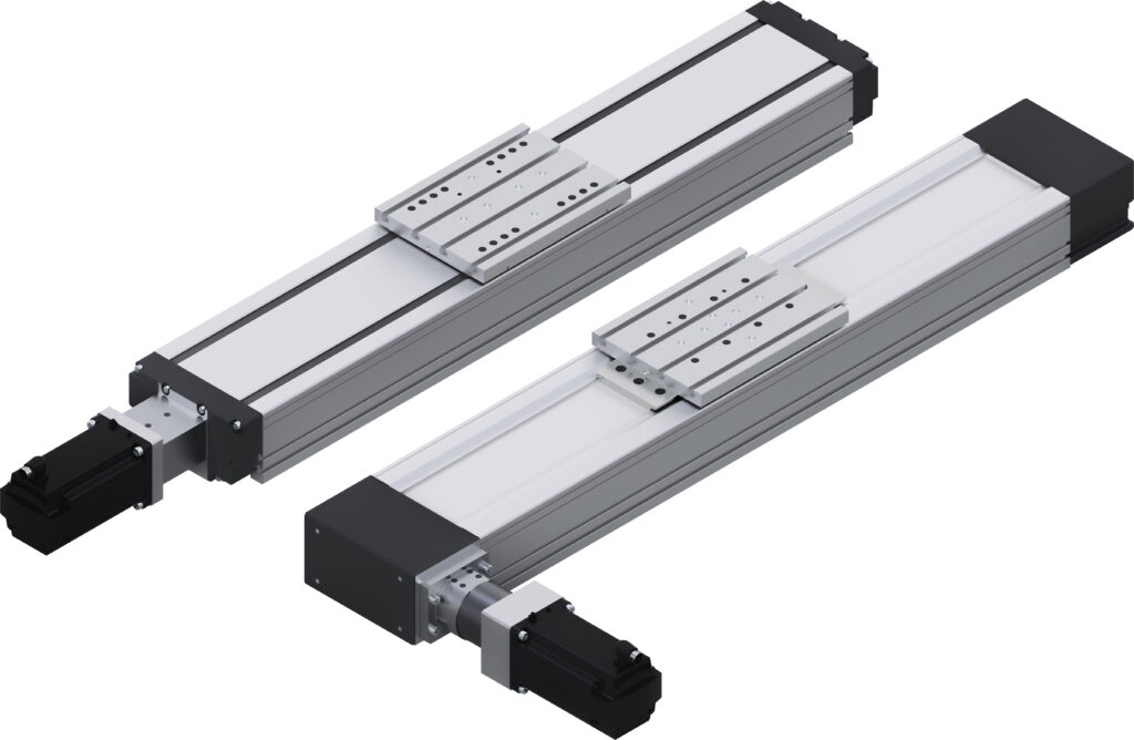

Linear-motion modules such as the one shown here are designed to perform with extremely high precision, including in extreme environments, with a repeatability of up to five micrometers.

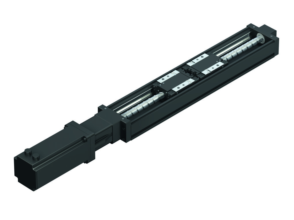

End users need to consider component design when building their extreme environment processes. Ballscrews such as the one here can withstand temperatures from -10°C to +80°C.
