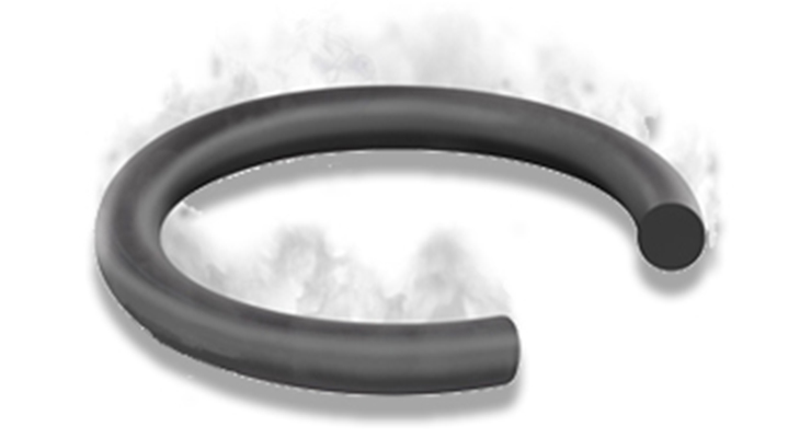

Outgassing — the release of gas or vapor from a material through desorption, sublimation (the transition of a material from solid directly to gas), or evaporation — is a critical parameter for materials used in vacuum environments. These gasses and vapors can affect the pressure (or level of vacuum) in the vacuum chamber, and outgassed compounds can condense on surfaces, damaging or destroying sensitive components such as lenses, semiconductor wafers, and microelectronic components. Outgassing can also degrade sterile environments in medical and pharmaceutical applications.

Outgassing is the release of gas or vapor from a material through desorption, sublimation, or evaporation.

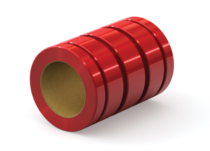

Plain bearings have an advantage over ball and roller type bearings in vacuum applications because they don’t require lubrication, so one source of outgassing is automatically eliminated. And they’re available in a variety of plastic and composite materials that have low outgassing properties.
linear motion outgassing
Plain linear bearings are offered in a wide range of materials with low outgassing, such as Frelon, a PTFE-based material used by PBC Linear, and some versions of iglidur material from igus.
