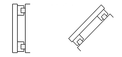

Oil lubrication is recommended for high-speed applications, because it dissipates heat more readily than grease. It also flows and disperses better than grease. But when oil lubrication is used, the orientation of the bearing and the location of the lubrication ports must be taken into account. When components are mounted on their sides or vertically, oil lubrication will not flow to bearings and raceways that are above the lube ports.
Bearing Lubrication
The orientation of components must be taken into account when oil lubrication is used.

    Worthwhile article, air-oil lubrication is one of our specialties, the paragraph on air-oil or mist for linear bearing agrees with our findings. The angle and position as well.
