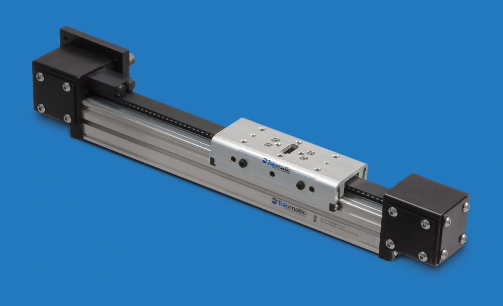

This Tolomatic MXB-S belt-driven actuator has a solid bearing design to boost performance in harsh environments — with load-carrying capacities up to 520 lb.
Belt driven actuators can use a variety of guide mechanisms, with plain bearings, cam-roller guides, and recirculating bearings (riding on a profiled rail or round shaft) being the most common. Because their strengths are high speeds and long strokes, belt-driven systems are often housed in an aluminum extrusion or in an open configuration with no protective housing.

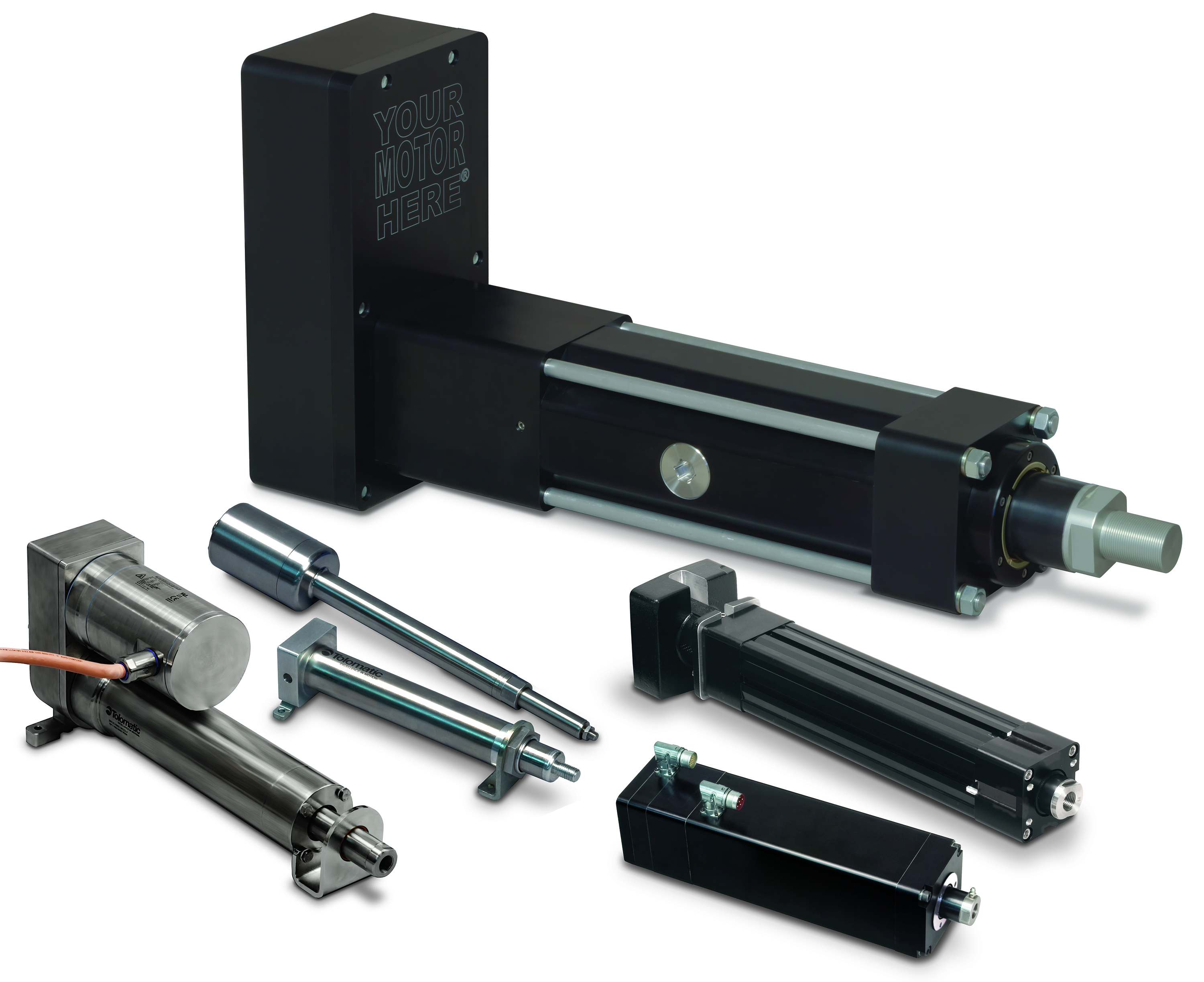

Electric rod-style actuators as those shown here deliver more performance, control, and efficiency than fluid-power (pneumatic and hydraulic) counterparts. Electric actuators meet motion-control needs ranging from low-cost to high-performance for myriad industries — from food and beverage processing and production to high-force timber processing. Design tip: Fully analyze the linear-motion application and determine the project’s exact parameters (such as loads, forces, application footprint and environment) before specifying an actuator. Careful upfront analysis reduces overall costs and makes for automation systems with higher reliability, better performance, lower energy expenditures, and less maintenance. Courtesy Tolomatic Inc.
