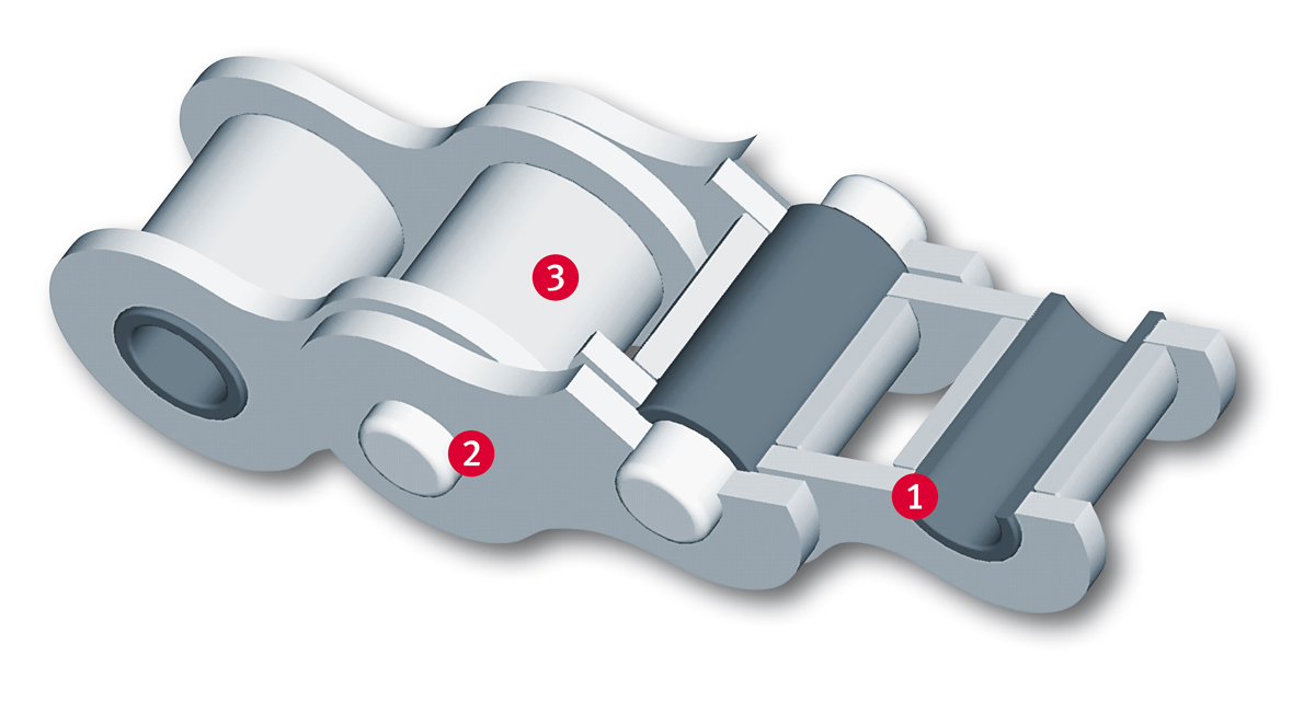

Megalife chains feature seamless sintered bushes made from a material developed specially for this product. For enhanced tribological properties, the bushes have been hardened and specially treated. The pin features a wear-resistant, friction-optimised surface coating, and the seamless roller has a corrosion-protected surface that is also wear-resistant. Thanks to these properties, the Megalife chains have a longer service life and greater strength than conventional low-maintenance chains. Their components are nickel-plated for corrosion protection and can be used in a temperature range from -40 to +160 °C. The maintenance-free chains can be supplied dry or with additional special lubrication to suit any application.
The Megalife I series products are suitable for normal chain applications without relubrication at speeds of up to 3 m/sec. Under certain conditions, the chains are entirely maintenance-free, can be easily dismantled and can be used in corrosive environments. Using the same range of attachments as iwis’ standard conveyor chains, the Megalife chains are fully compatible with the standard products. As well as roller chains, the Megalife I series also includes transfer chain, accumulation chain and grip chain variants.
The Megalife II series offers a setup for demanding applications with high-speed chain drives running at more than 3 m/s and exposed to high loads. The pins are treated in a special thermochemical process to achieve an exceptional surface hardness and suitable adhesive strength, which improves the chains’ wear resistance and lifespan. Being used mainly as drive chains, they are not suitable, however, for corrosive environments.
