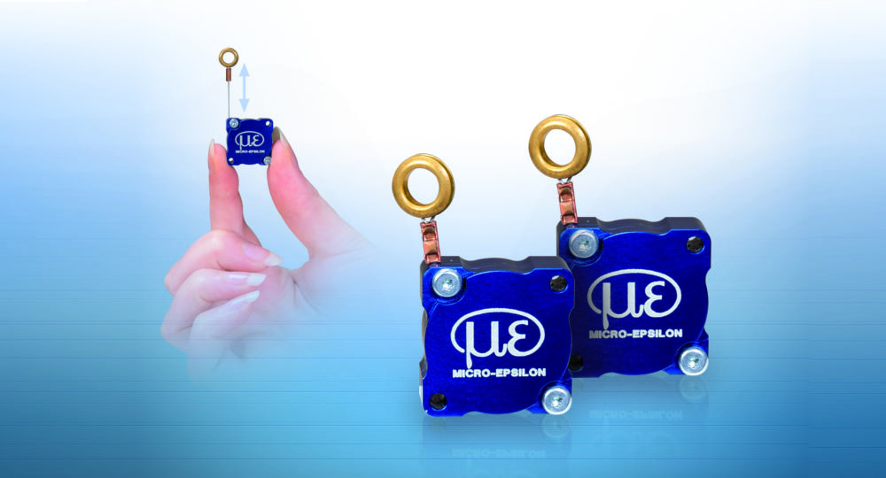

The new Micro-Epsilon wireSENSOR MT19 draw-wire sensor has a weight of only 8 g and a size of just 19 x 19 mm. This wireSENSOR MT19 linear sensor is used for displacement and distance measurements with a measuring range of 40 mm.
The dynamic sensor is compact and enables wire accelerations up to 60 g.
The new MT series from Micro-Epsilon also includes the MT33 and MT56 draw-wire sensors, which stand out due to an ultra-compact design relative to their measuring ranges.
The new wireSENSOR MT series from Micro-Epsilon includes extremely compact draw-wire displacement sensors which can be integrated into very tight spaces. The wireSENSOR MT19 model is the smallest draw-wire sensor in the world. With a measuring range up to 40 mm and wire accelerations up to 60 g, the sensor is particularly suitable for use in applications where high dynamics are needed (crash tests, simulators or test benches).
This series comprises two more miniature draw-wire sensors – the MT33 and MT56 models which cover measuring ranges up to 130 mm. In relation to their measuring ranges, the design is kept as compact as possible.
Equipped with a robust aluminum housing, these three miniature draw-wire sensors are ideally suited to industrial applications. Two through-bores in the housing and an integrated eyelet attached to the measuring wire enable fast and easy mounting.
