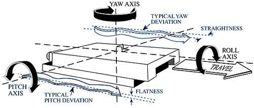

An example of degrees of freedom in linear motion is a bearing block mounted to a profiled linear guide. The bearing has only one degree of freedom, since it can only move along one axis, typically referred to as the X axis. Motions in the other five degrees of freedom — translation along the Y and Z axes and all three rotational motions — are constrained by the guide being mounting to the rail.
degrees of freedom
The bearing on a linear rail can only move in one direction, with motion in the other two translational axes and three rotational axes constrained. Therefore, it has only one degree of freedom.
Image credit: Renishaw
However, just because motion is constrained in the other five degrees of freedom doesn’t mean that there is zero movement in those axes. This is because deflection of the bearing block can introduce small motions in the constrained degrees of freedom. For example, loads placed on the bearing in the downward (Z) or lateral (Y) direction can cause the bearing to deflect in those directions. And offset, or moment, loads applied to the bearing can cause it to rotate slightly around any of the three axes. These motions due to deflection in the constrained degrees of freedom are planar and angular errors.
motion errors
Motions in the constrained degrees of freedom represent planar and angular errors.
