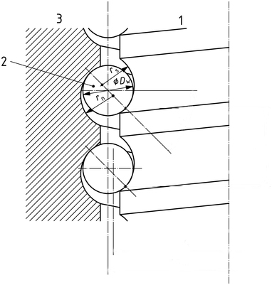

In ball screw assemblies, the raceway on the screw shaft has a different radius than the raceway inside the ball nut housing. Therefore, there are two measures of conformity for ball screws:
ball nut conformity
1 – ball screw shaft
2 – ball
3 – ball nut
Image credit: ISO
frs = conformity between ball and screw shaft
rs = radius of screw shaft raceway (mm)
Dw = diameter of ball (mm)
frn = conformity between ball and nut housing
rn = radius of nut housing raceway (mm)

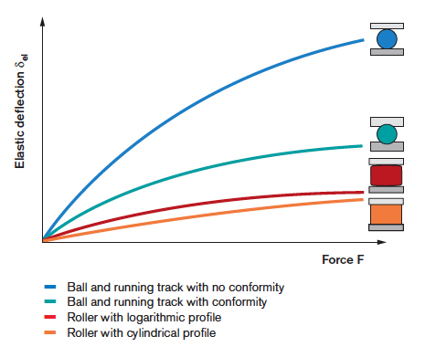

Conformity is also an important factor in the effectiveness of lubrication. The small area of contact that arises when a ball or roller experiences conformity with its raceway results in very high contact pressure. This high contact pressure increases the viscosity of the lubrication, which improves the lubrication’s ability to support the load without being squeezed out of the small contact zone. And because the area of contact is relatively large — compared to point or line contact — conformal bearings experience less deflection than bearings that ride on planar surfaces and have no (or very little) conformity.
deflection and conformity
The more conformity between the rolling element and the raceway, the lower the deflection for a given load.
