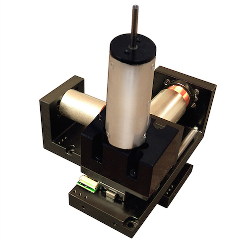

Moticont has released a new three-axis XYZ linear actuator, the XYZ-10. The X and Y axis of the actuator each has 0.97 in. (24.6 mm) of travel and the Z axis has a stroke of 0.500 in. (12.7 mm). The high-speed, high-acceleration, zero-cogging, brushless voice coil motors provide 6.3 lb (28.2 N) of force and peak forces of 20.0 lb (89.9 N) at a 10% duty cycle for the X and Y axes. The Z-axis linear actuator has a continuous force of 21.2 oz (5.9 N) and 67.0 oz (18.6 N) peak force.
voice coil actuator
The VCLM-XYZ-51-032-025-070 three-axis linear actuator stage features resolutions of 1.0 micron for the X and Y axis, with the Z axis having a resolution of 1.25 microns. All axes are equipped with a HOME switch. The stationary axis has a footprint of only 2.00 x 5.00 in. (50.8 x 127.0 mm) with convenient mounting holes and an internal thread on the non-rotating shaft of the Z-axis actuator. This XYZ actuator can easily be integrated into new and existing applications such as assembly, pick-and-place, testing, inspection, sampling, and probing applications, especially in confined spaces.
Moticont can quickly provide the XYZ-10 three axis linear actuator as an easy to install complete plug-and-play linear motion system including the servo controller.
