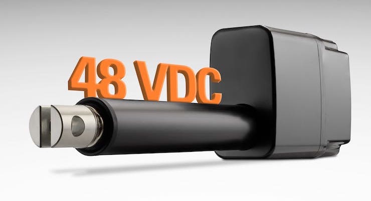

Thomson Industries, Inc., has announced that its Electrak MD actuator now has a 48-V rating. The availability of a 48-V actuator that can handle loads of up to 2 kN (about 450 lb.) equips battery powered system designers with energy efficiency, cable management and control capability that might otherwise require larger, more expensive actuators.
“The more electrical functionality and axes of motion on a vehicle, the more sense it makes to use higher-voltage batteries to drive the actuators. By upgrading our Electrak MD actuators to handle 48 V, we have reduced the current draw to half that of a 24-V actuator and a quarter of that of a 12-V actuator. This opens new doors to value-added innovation in mobile systems,” said Anders Karlsson, Senior Product Manager – Linear Actuators at Thomson.
