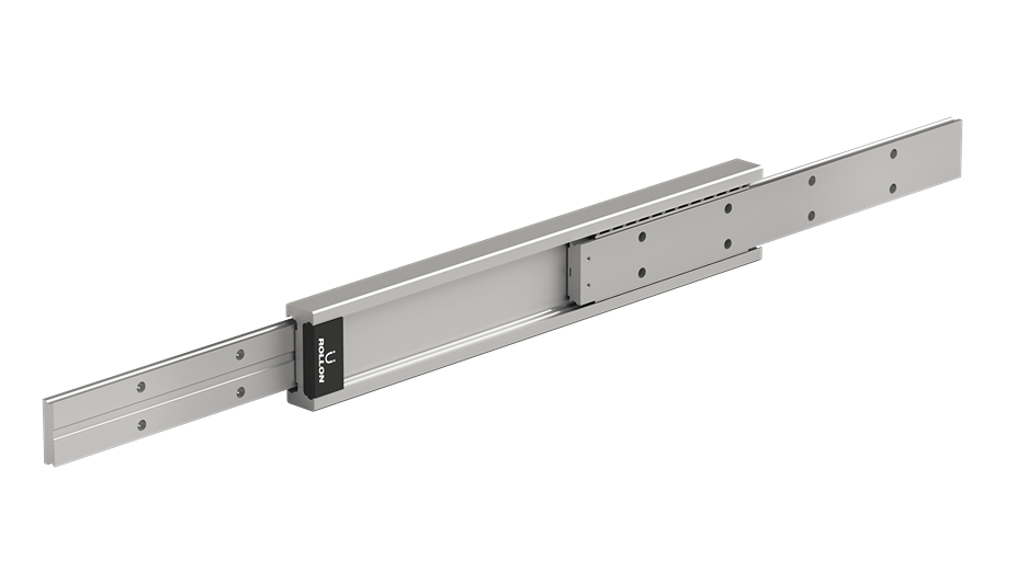

Rollon has introduced the HGT-MG telescopic rail, an addition to its HGT product range. The new version includes a redesigned ball cage and synchronization magnets to support load handling, improve extension smoothness and increase durability.
The new HGT-MG telescopic rail features a redesigned ball cage and magnets for synchronized movement. (Pictures © Rollon)

The HGT-MG is available in sizes 60 and 80 and features a newly engineered ball cage with a reduced pitch and end blocks containing internal magnets. These magnets align and synchronize the elements during extension, reducing the force needed to open the rail. This design supports higher loads and enables smoother operation. The damped end stroke also helps lower noise and limit mechanical stress, which can extend service life.

HGT telescopic rails are fully extending, heavy-duty components intended for demanding operating conditions. They use a double T-shaped intermediate element and two matching sliders. All rails and sliders are available in steel with zinc electroplating and thick-film passivation and meet REACH and RoHS requirements. A stainless-steel version is also available.
HGT rails are used in construction and machinery applications, as well as in automotive and rail systems. Their design supports high loads while maintaining rigidity and low deflection, providing a compact option for spaces where installation room is limited.
