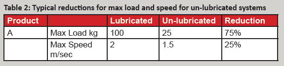

Operation in an un-lubricated state
While not recommended, it’s possible to run most systems without lubrication; however, there will be significant reductions to maximum load, maximum speed and expected life. Table 2 shows that a typical un-lubricated system will have a significantly reduced maximum load and a reduced maximum speed when compared to a properly lubricated system.
Table-2-Typical-reductions-for-max-load-and-speed-for-un-lubricated-systems
Table-3-Typical-life-reductions-for-un-lubricated-systems
In addition to significant reductions in maximum load and speed, un-lubricated systems will also experience an extreme reduction in expected life. Table 3 shows the expected life for both a lubricated and un-lubricated system for two different products with two different applied loads. The approximate reduction in lifetime has also been calculated.
