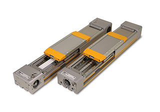

Parker’s Electromechanical Automation Division, a leading supplier of motion control technology, is pleased to announce the domestic manufacturing for the complete line of High Moment Rodless (HMR) electromechanical linear actuators.
“This move will serve to greatly improve product lead times as well as offering greater levels of customer support and customization options,” says Jeremy Miller, Parker’s Linear Mechanics Product Manager. New customization options include a parallel motor mount, purge ports, multi-axis configurations, and pinning options, amongst a multitude of others.Linear Actuator
In addition, the standard configurable option set has been extended to include a number of new features, including mounting to Parker Automation’s North American motor and gearhead complement. This includes “Express” options for pre-mounted motors and gearheads from our most popular product families. These “Express” options have been configured to maximize system performance and provide a competitively priced, complete electromechanical solution, captured in a single part number. Seamlessly pairing this actuator package with Parker’s complete line of servo drive and control products provides truly optimized electromechanical system performance.
Parker’s new HMR represents one of the most versatile actuator lines on the market today. With five different frame sizes, two different drive train options, multiple motor mounting, carriage and sensor options, and an IP54 protective cover option, along with a multitude of other customizable features, the HMR was designed with application optimization in mind and with a goal of reducing overall design time, along with simplifying the installation and integration of this actuator into a system.
“Guided by two precision square rail bearings, the HMR has enormous moment and payload capacity bundled in a low-profile yet sleek package,” says Miller. “The options of either a high-efficiency timing belt drive or a precision ball screw with multiple lead options allow the user to maximize performance within their system.” Ease of use was at the core of this new actuator design, by integrating externally accessible lubrication fittings into the carriage, which evenly disperse lubricant across the bearing trucks and ball nut making for easier machine maintenance and driving down overall maintenance costs. In addition, there are options for two different chassis profiles, allowing the user to choose between a super-low-profile and cost-effective “basic” version, or a “reinforced” version providing great structural rigidity for long unsupported spans.
Potential applications for the HMR include packaging equipment, material handling, robot transfer, and other general automation applications, but given the extensive adaptability of this actuator, it is ideally suited for seamless integration into any machine layout.
