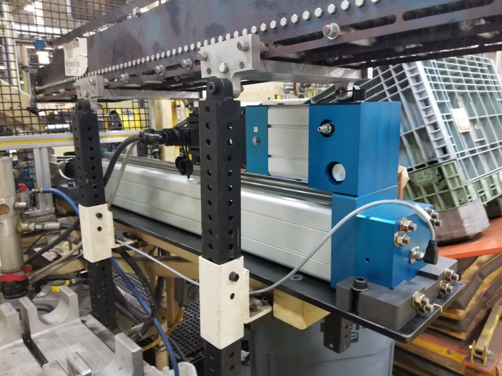

A tier-one automotive supplier was experiencing roller-screw actuator failures on their damper and bearing presses. These were replaced with hybrid actuators leveraging the strengths of electric and hydraulic technologies to withstand the shock loads. Image: Kyntronics

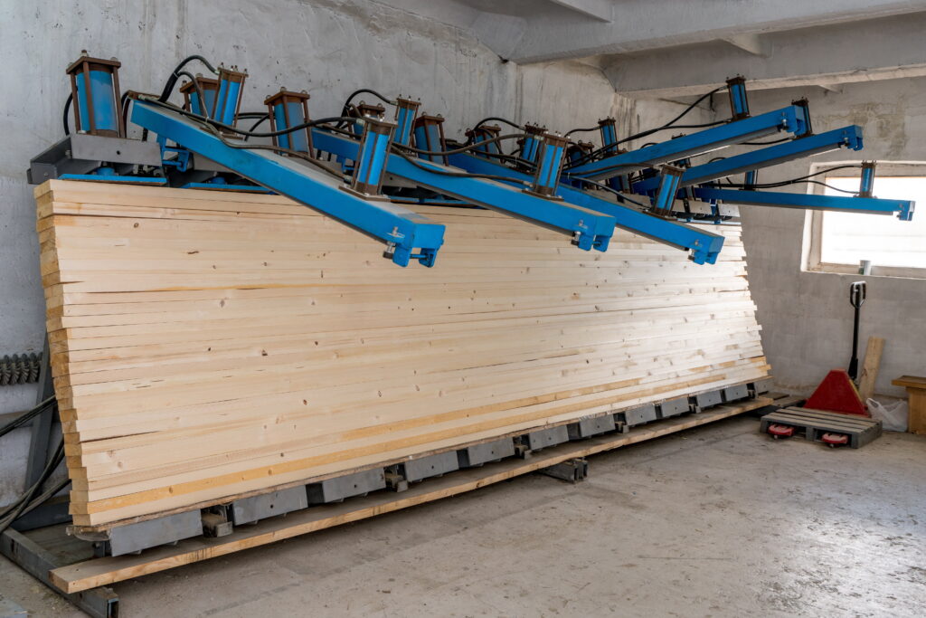

Glue-laminated (glulam) beam presses form engineered wood products with multiple hydraulic cylinders or electric actuators (along with plain bushings or heavy-duty shielded linear guides) along the press length providing clamp force. Complementing these axes are lateral positioning carriages that in some cases ride linear guides or cam followers on structural rails. Stiffness and uniform pressure distribution are key. Image: Adobe Stock

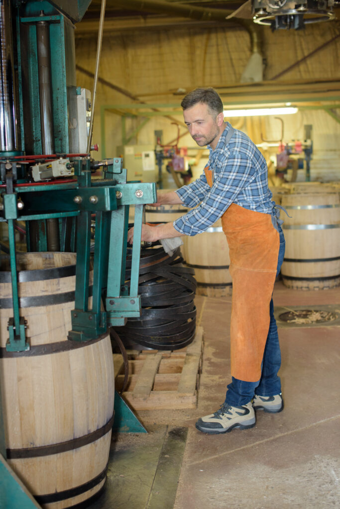

Pressing hoops onto a wine-barrel assembly requires radial-compression equipment with relatively low force. Most common is hydraulic or pneumatic actuation of the presses’ segmented jaws complemented by guidance via round shafts (and ball bushings) or simple slide plates. Image: Adobe Stock

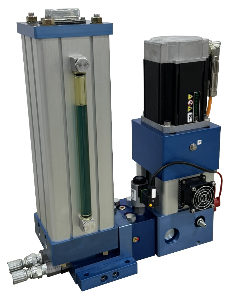

One last option for press actuation is hybrid electric-hydraulic actuation. Components of this type directly integrate a fluid cylinder with a servomotor that drives a pump. The latter in turn generates hydraulic pressure within the sealed actuator assembly so there’s no need for a centralized hydraulic power unit, external hoses, or reservoirs.
Kyntronics’ Servo Power Units (SPUs) are compact servodriven hydraulic power sources that replace traditional hydraulic power units. More specifically, SPUs incorporate a servomotor, pump, valving, and rod compensation reservoir to directly connect to an external cylinder or rotary actuator through quick-connect couplings. The SPU is typically located very close to the cylinder or rotary actuator to minimize fluid and efficiency losses. Most SPUs are used to operate a single cylinder, though they can operate multiple cylinders.
Output from these hybrid actuators is 100 to 150,000 lb that’s precisely controlled to deliver specific positions, forces, speeds, and dwell times set by servolevel programming. Power-on-demand operation makes for energy consumption that’s lower than that of traditional hydraulic systems. Plus, a sealed actuator body minimizes maintenance requirements and prevents leaks.
Thanks to their hydraulic force transmission, hybrid actuators can also tolerate the shock loads commonly encountered in pressing applications.
