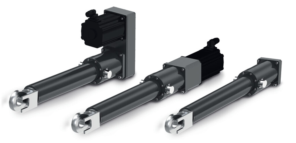

Schaeffler Ewellix SRSA/SVSA electric cylinders are the fastest and strongest linear actuators in Schaeffler’s portfolio. Planetary roller screws help deliver efficient linear movements with extremely high loads and full controllability at high speed. Housings are made of steel for high stiffness and robustness.
Ballscrews have lower load capacity than fluid-power solutions yet are extremely precise. Planetary roller screws, which use threaded rollers rather than balls for more contact (and therefore transmit more power) can output axial forces approaching those of some hydraulic cylinders … though the peak force density of all but the largest roller screws is still lower than that of hydraulics.

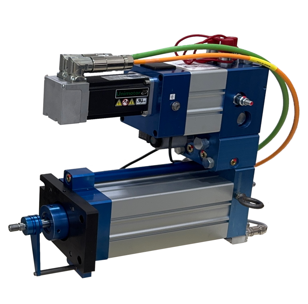

Kyntronics’ Servo Hydraulic Actuators (SHAs) deliver precise servo control through built-in position sensors and pressure transducers. They only draw power when needed (power-on-demand) and support IoT functions such as predictive maintenance and overall equipment effectiveness (OEE) monitoring. The actuator has many configurations and can be installed in any orientation.
That said, many applications’ requirements are within the ranges of stock electric cylinders based on planetary roller screws. A representative actuator with a 75-mm cylinder screw size might deliver peak forces to 500 kN — previously possible only with hydraulics. What’s more, the precision recirculating roller screws and short screw leads (1 mm) deliver this force with high positioning accuracy for positioning adjustments controllable down to micrometers.
A Kyntronics SHA hybrid linear actuator is a self-contained actuation system that integrates a motor, pump, and valving directly onto a hydraulic cylinder. Unlike traditional hydraulics, there’s no separate hydraulic power unit or leak points.

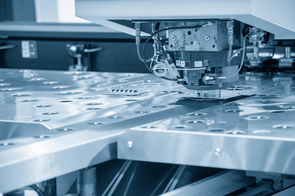

Aluminum punch presses such as the turret punch press shown here increasingly use servoelectrically screw-driven rams complemented by ballscrew or linear-motor driven sheet-positioning tables on profile-rail linear guides. Image: Adobe Stock
