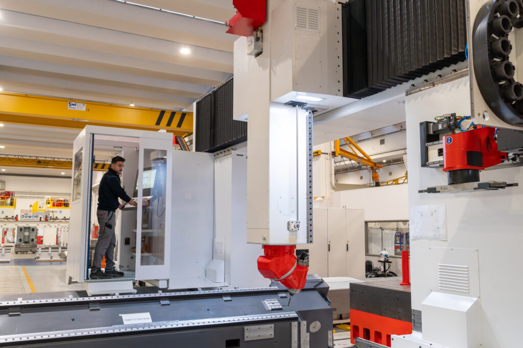

This EMCO milling machine maintains precision with controls that include a Renishaw RMP60 radio probe, kinematic measurement, and laser system for detecting tool length and diameter. This in turn reduces errors and increases operational reliability.

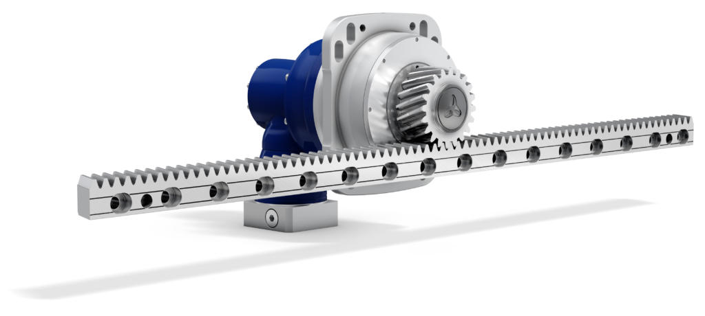

Wittenstein sets find copious use in precision machine-tool applications. Some feature the supplier’s RPK+ hypoid gearbox optimized for rack-and-pinion sets. The pinions are specially matched to the gearbox for transmission of maximum feed forces.
