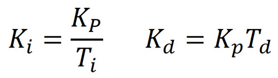

Where Kp is the proportional gain, Ti is the integral time constant, and Td is the derivative time constant. Letting Ki be the integral gain and Kd the derivative gain:
With these terms, the parallel form of the PID controller can be implemented:

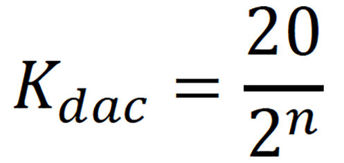

The DAC is modeled as a constant gain with n bit resolution:
Letting n= 14 bit:

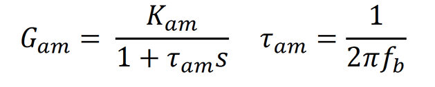

The amplifier is modeled as a constant gain Kam. To account for its limited bandwidth fb a first-order low-pass filter is added. The time constant of the filter is τam:
Letting Kam = 2 amps/volt and fb = 2,000 Hz:

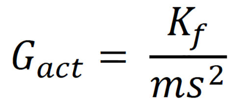

The linear actuator is modeled as a gain Kf — the linear motor force constant plus the Laplace transform of F = ma. Here, a is the acceleration and m is the mass of the actuator and payload. The model assumes no friction as the system will be using an air bearing. The actuator transfer function with output in position (meters) and input in current (amps):
Letting Kf = 8.9 Newton/Amp and m = 00.5 kg:

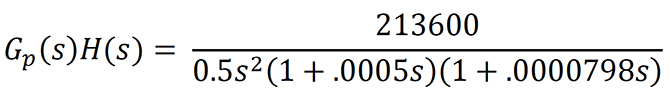

The multiplication of all elements from the zero-order hold to the linear encoder is known as the open-loop function — Gp(s)H(s). The open-loop function in this frequency domain analysis is:

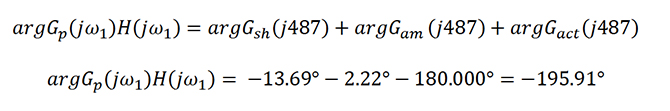

First — we need to calculate the phase of Gp(jω1)H(jω1) or argGp(jω1)H(jω1). This is the addition of the phase shift for each element of the open-loop function at the specified frequency ω1. The specified frequency must be chosen … let us choose 487 radians/sec:

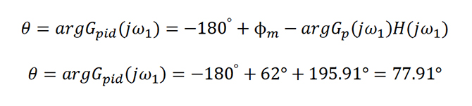

Fourth — the argument or phase shift contribution of the PID controller can then be found:

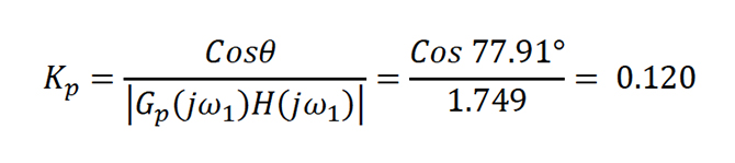

The magnitude of θ must be less than 90° … Now we can solve for the PID proportional gain:

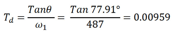

Solving for the derivative time constant:

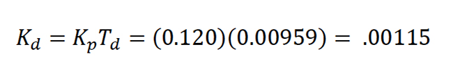

Solving for the PID derivative gain:

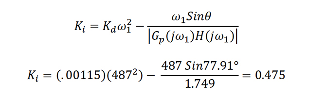

Lastly, solving for the PID integral gain:
