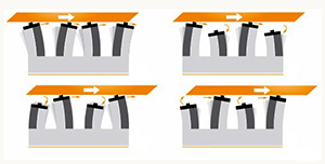

In a linear stepper piezo motor, pairs of piezo actuators work together, like legs, to create a walking motion that advances a longitudinal rod.
Image credit: MICROMO
Stages using piezo stepper motor technology can produce forces in the 10 N range, but at speeds of around 10 mm/s. Their strength lies in extremely small motions, with minimum incremental motion (MIM) capabilities in the single-nanometer range, over long stroke lengths. On the other hand, stages using ultrasonic piezo motors can typically produce minimum incremental motions of a few hundred nanometers over strokes up to about 50 mm. But they have the highest speed capabilities, at around 200 mm/s, with force production of a few newtons. Stages using piezo inertia motors have performance characteristics (minimum incremental motion, speed, and force) similar to those using piezo stepper motors, but in a more compact footprint — and typically at lower cost.

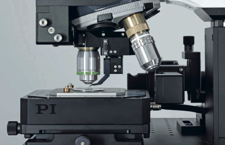

Piezo-driven stages are often used in microscopy and other optical applications.
Image credit: PI
One of the strengths of piezo motor stages over other direct drive technologies is that they can produce high holding forces when powered off, which eliminates heat generation when a load is being held in place. Piezo-driven systems also have a very high force-to-size ratio.
