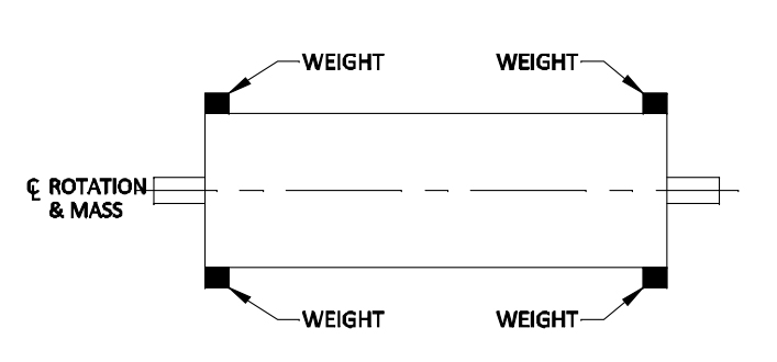

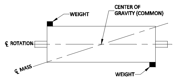

Dynamic balancing
Dynamic balancing – also referred to as “two-plane balancing” – goes one step beyond static balancing and ensures that the pulley’s center of mass is on the same axis as its center of rotation. It is possible for a pulley to be statically balanced but dynamically unbalanced (although the reverse is not true), so dynamic balance must be measured while the pulley is turning.
Image credit: PCI, ProCal Inc.
Because it involves forces in two planes, dynamic balancing requires that masses be added in two planes to counter the imbalances and prevent pulley vibration.
The measure of unbalance is given in units of g-mm (oz-in), based on the mass of the pulley and the eccentricity (the distance between the center of mass and the center of rotation). The Mechanical Power Transmission Association provides guidelines for both static (one-plane) and dynamic (two-plane) balancing in their standard, MPTA-B2c-2011: Standard Practice for Sheave/Pulley Balancing.
