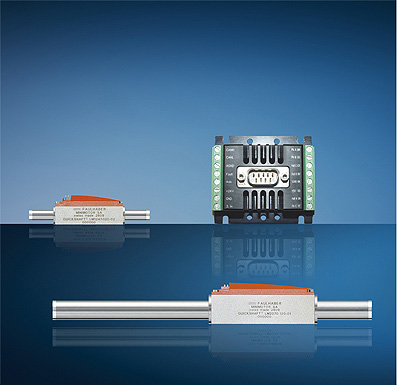

The LM 1247 motor from MicroMo is a typical example of small direct drive linear servomotors. A three-phase delta-wound coil drives the output shaft containing embedded permanent magnets, while Hall Effect sensors monitor shaft position.

The stator measures just 12.5 x 19.9 x 49.4 mm (W x H x L), including power connection. The rotor bar comes in two versions, each 6.3 mm in diameter and 82 or 154 mm long. This makes stroke lengths of up to 20 or 80 mm possible, which is sufficient for many microdrive applications.
The resolution or smallest possible movement of the rotor bar is just 6 µm, and repeatability (maximum deviation on multiple movements of the same kind) is 40_µm. Three linear Hall sensors combined with a motion controller limit the maximum positional error, or the difference between the set and measured position of the system, to 120_µm. As all values are determined solely electronically, mechanical tolerances, wear and tear and thermal expansion of components are of no consequence.

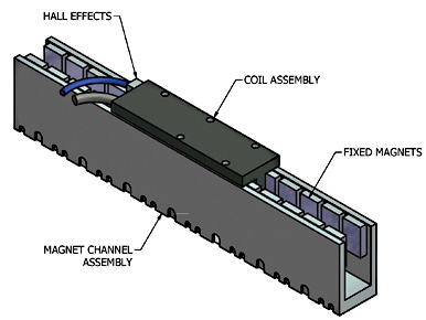

Traditional linear motors were basically a permanent-magnet rotary motor rolled out and laid flat. Imagine the stator and rotor being cut along a radial plane and then unrolled so that they could provide linear thrust. Energizing the stationary part of the motor causes motion in the moving part, which typically contains some type of conductive material.

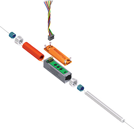

The new linear electric motor design goes back to rotary ideas. The motor itself is contained within a nonmagnetic steel housing. A self-supporting coil sits inside, along with the sleeve bearing of the forcer rod made out of special slide-bearing material. The coils are glued and connected together and after the insertion in the housing a plastic injection makes for a self-supporting structure so that there is no core for the structure rigidity. Inside the forcer rod-a high-precision sliding cylinder-are small ultrastrong permanent magnets in the shape of a disk. The rod-magnet assembly is free to move inside and out of the coil. As the coil is energized and de-energized, this produces a magnetic field which can move the forcer rod forward or backward, creating motion. A circuit board with electronics for the three Hall sensors that determine positioning is hidden under the top cover, along with the power connection.
Traditional linear motors are essentially a permanent-magnet rotary motor rolled out and laid flat. Energizing the coil assembly produces motion.
