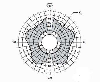

With conformity between the balls and raceways, profiled rail systems have a larger contact area, and thus a higher load carrying capacity for a given size, than round shaft systems. Profiled rails are also better suited for moment loads than round shafts are, and typically have equal load capacities in all four directions. Conversely, the load capacity for round shafts depends on the direction of loading, which is the orientation of the load to the ball bushing.
Round Shaft Guides Polar Graph
For round shaft assemblies, load correction factors are based on the orientation of the load relative to the linear bushing.
Image credit: Thomson Industries

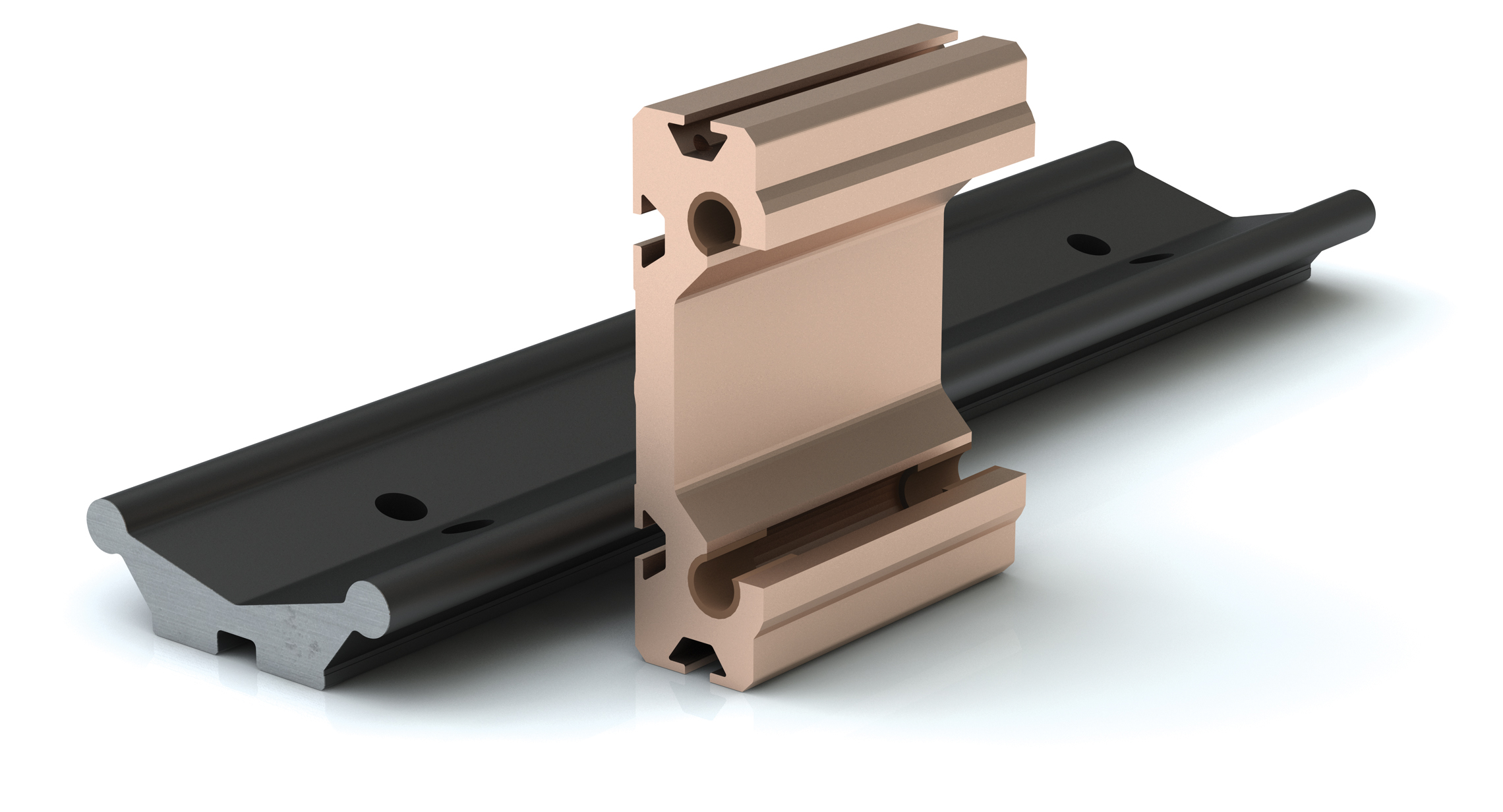

Round shafts are generally less sensitive to debris than profiled rails and are available in a variety of materials, coatings, and sealing options to withstand caustic or abrasive contamination. These range from all steel ball bushings to assemblies composed of stainless steel shafts with plastic bushings.
LEE Linear round rail with plain bearings is rugged linear motion option
Profiled rails often offer higher load capacity, rigidity, and accuracy. Round shafts as the ones shown here are often easier to integrate, more rugged, more forgiving of installation challenges, and lower maintenance. Image courtesy Lee Linear
