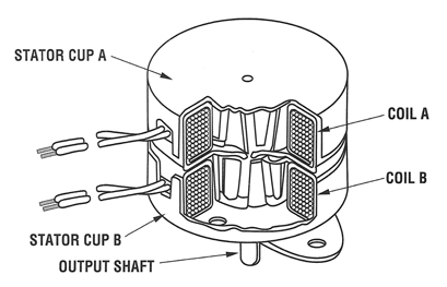

Permanent magnet stepper motors
Permanent magnet types have a permanent magnet rotor that is axially magnetized, meaning it has alternating north and south poles parallel to the rotor shaft. These motors are also referred to as “can stack” or “tin can” motors because their stators consist of two coils contained in soft iron housings (i.e. “cans”) with teeth on the inside that interact with the rotor.
Permanent magnet steppers typically have a step angle of 3.6 degrees (100 steps per revolution), although models are available with 1.8 degree step angles. These motors can be operated in full-step, half-step, or microstepping modes for higher resolution. Permanent magnet stepper motors have higher torque capabilities than variable reluctance types (see below), but at limited speeds, so they’re best for applications that require low to moderate torque at low speeds.
stepper motors
The most common design of a permanent magnet motor is also referred to as “can stack” or “tin can” design, because the stator consists of two coils contained in soft iron housings (i.e. “cans”).
Image credit: Applied Motion Products, Inc.
