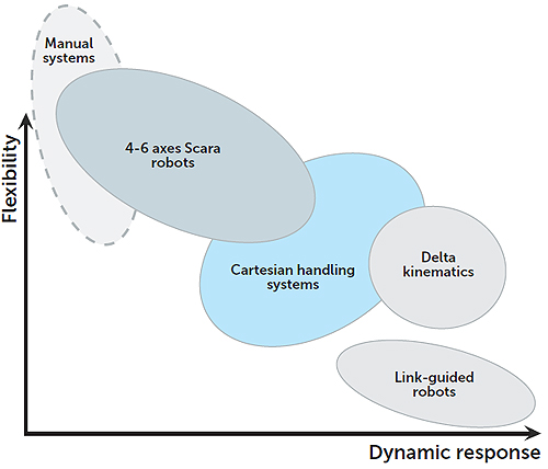

Cartesian handling systems and conventional robots with 4 to 6 axes have a relatively large overlap in terms of flexibility and dynamic response but differ when it comes to their mechanical system. Depending on the application, Cartesian handling systems are controlled either by a simple PLC (which a user may already have) for point-to-point movements or by a complex control system with robotic functions, such as for path movement. The 4- to 6-axes robots always require a complex robot control system.

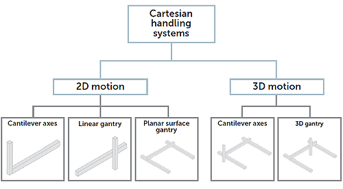

cartesian-handling-system-overview
Overview of Cartesian handling systems.

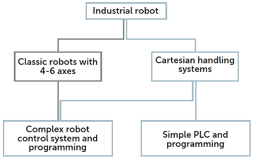

robot-control-system-relationships
Relationships between robots and control systems.

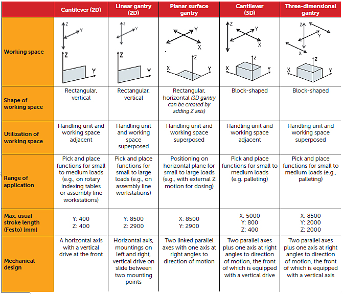

Two-dimensional – These Cartesian handling systems are divided into the categories of cantilevers and linear gantries with their movement in the vertical plane, and planar surface gantries with their movement in the horizontal plane.
A 2D cantilever consists of a horizontal axis (Y) with a vertical drive (Z) mounted on the front of it.
A linear gantry is a horizontal axis (Y) secured at both ends, left and right. A vertical axis (Z) is mounted on a slide between the two end points of the axis. Linear gantries are usually slim, with a rectangular vertical working space.
A planar surface gantry consists of two parallel axes (X) linked by an axis (Y) perpendicular to the direction of movement. Planar surface gantries can cover a significantly larger working space than robot systems with delta kinematics or SCARA with their circular/kidney-shaped working spaces.
In addition to the conventional configuration with individual axes, linear gantries and planar surface gantries also take the form of complete systems with a fixed mechanical combination with a rotating toothed-belt as the driving component. The low effective load makes them suitable for high capacities (picks/min) with corresponding dynamic response.
Three-dimensional – These Cartesian handling systems are divided into the categories of cantilevers and 3D gantries with movements on both planes.
3D cantilevers are two axes (X) mounted in parallel plus a cantilever axis (Y) perpendicular to the direction of movement, with a vertical axis (Z) mounted on the front of it.
3D gantries consist of two parallel axes (X) linked by an axis (Y) perpendicular to the direction of movement. A vertical axis (Z) is mounted on this perpendicular axis.
Note: With planar surface, linear and 3D gantries, the force is applied between the two points of support of the horizontal axes. The horizontal axis on the cantilever acts as a lever due to the load suspended on its end.
Simpler programming required
The degree of programming required depends on the function: If the system only needs to move to individual points, quick and simple PLC programming is sufficient.
If path movement is necessary, such as when applying adhesive, PLC control is no longer sufficient. In such cases, conventional robot programming is required for Cartesian handling systems too. However, the control environment for Cartesian handling systems offers a large range of possible alternatives when compared with conventional robots. Whereas conventional robots always require use of the manufacturer’s specific control system, any PLC can be used for Cartesian handling systems, in the version with the best range of functions for the application’s requirements and complexity. This means customer specifications can be adhered to and a uniform control platform can be implemented, including a uniform programming language and program structure.
With conventional robots, complex programming is often required. Consequently, a great deal of work is needed to use 4- to 6-axes systems for mechanical tasks. For example, all 6 axes always need to be moved at the same time for straight-line travel. It is also difficult and time-consuming to program “right arm to left arm” in conventional robotic applications. Cartesian handling systems offer excellent alternatives here.

cartesian-system-table
