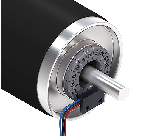

Applications: Hall-effect sensors only work in industrial and motion-control applications with low dc voltage and current values. These sensors are common in high-speed applications such as rotary speed tracking on linear conveyors. For example, a Hall-effect speed sensor might detect a rotating 16-pole ring magnet. Here, the Hall-effect sensor activates with each passing north-pole segment and deactivates with each passing south-pole segment. Then the sensor sends these signals to the control unit.

The problem: Initially, the machine builder wanted a Hall-effect speed sensor mounted to an industrial belt-drive system on a conveyor. Extensive communication between the end user and design-engineering teams made it clear that a standard Hall-effect sensor wouldn’t meet the requirements for electromagnetic compatibility (EMC), electromagnetic interference (EMI) or electrostatic discharge (ESD), because the electric motor running the conveyor was too close to the sensor’s location.
Other requirements: The end user needed a custom sensor setup with 24-AWG insulated lead wires connected to the standard Hall-effect sensor through an uncontrolled environment. The lead wires had to withstand potential hazards within the factory such as dust, chemicals, oils and vibrations. They also had to continuously send speed signals to a microprocessor control unit.
The Hall-effect speed tracking had to be upgraded to handle the speed and relative magnetic circuit of the sensor’s actuator. The sensor had to bridge the required 2-mm gap between the sensor and the magnet.
The solution: The engineering team developed a robust custom design with additional capacitive and resistor circuitry on a printed circuit board. That gave the sensor extra EMI, EMC and ESD protection. The sensor’s injection-molded capsule was made larger than the standard capsule to accomodate the new circuitry. In addition, the lead wires were upgraded to 20 AWG with Teflon insulation.
The manufcturer designed a true speed-sensing Hall-effect chip to replace the digital Hall-effect chip and get more accurate speed signals.
The design team also used computer simulation to identify the optimum magnet design for the 2-mm sensing gap. They determined that a 16-pole toroid magnet (with eight pole pairs) would maximize magnetic-circuit reliability. So now, the new injection-molded capsules work for other designs without forcing the end user to pay for tooling.
