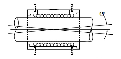

When a shaft deflects, misalignment occurs between the axis of the shaft and the axis of the bushing.
Image credit: Thomson Linear
Another example is a misalignment factor. When shafts are not supported along their entire length, they can experience deflection, which causes misalignment of the bushing relative to the shaft. This is especially problematic if the bushing is not a self-aligning type, as it results in uneven loading on the load-carrying balls. If misalignment exceeds a given value (but remains below the maximum allowable), then a misalignment factor must be applied to the dynamic load capacity.
