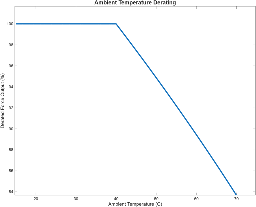

High ambient temperatures handicap motor output.
Ambient temperature: When a linear motor must operate in a hot factory setting or in a confined space, its force must be derated, and a larger motor may be required. The required amount of derating depends on ambient temperatures:
As ambient temperature approaches the motor’s thermal limits, the acceptable amount of time for maximum power is more and more brief until it’s only instantaneously possible.

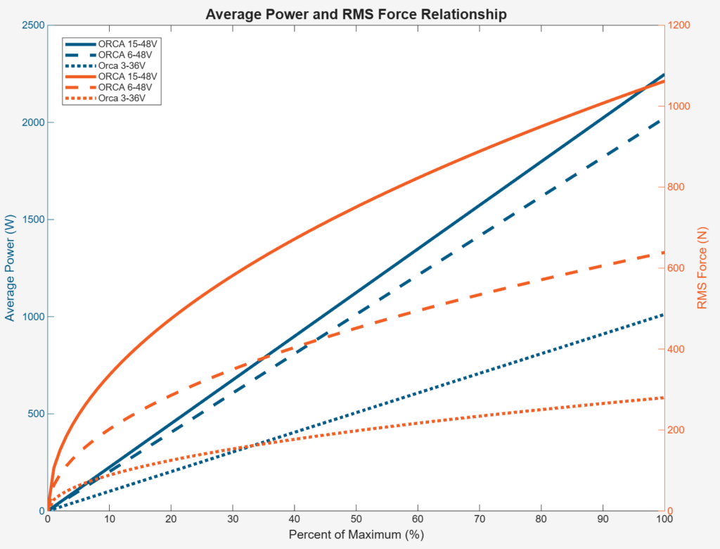

Decrease average power: Effective thermal management starts with reducing average power draw because root-mean-square RMS force rather than instantaneous peak force causes sustained heating. Reduction is possible with gentler accelerations, smoother motion commands, reduced holding duty cycles, or and more mechanical advantage (as with spring or pneumatic assistance).
Shown here is the relationship between force and power.

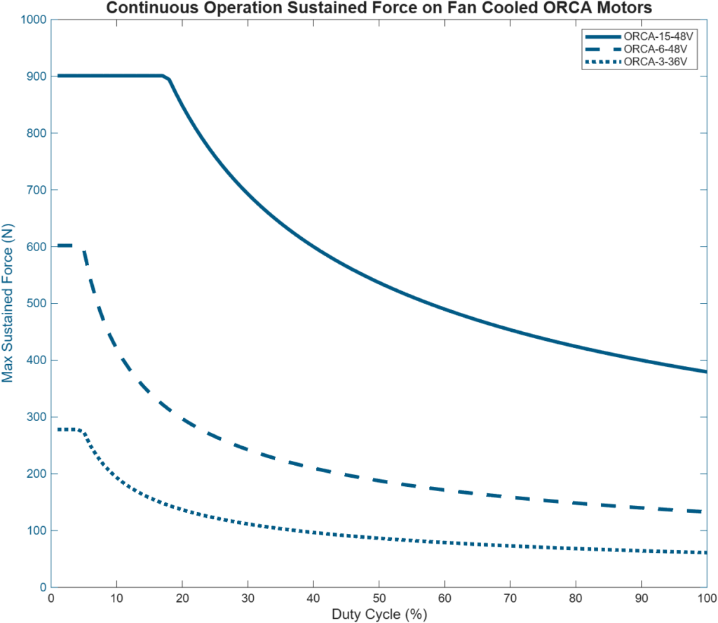

Shown here is how long forces can be held with different Iris Dynamics ORCA motors (having different thermal masses and force constants) as they warm from 20° C to 70° C. Protective cutoffs are set at 120° C for the coils and 70° C or the PCBs.
