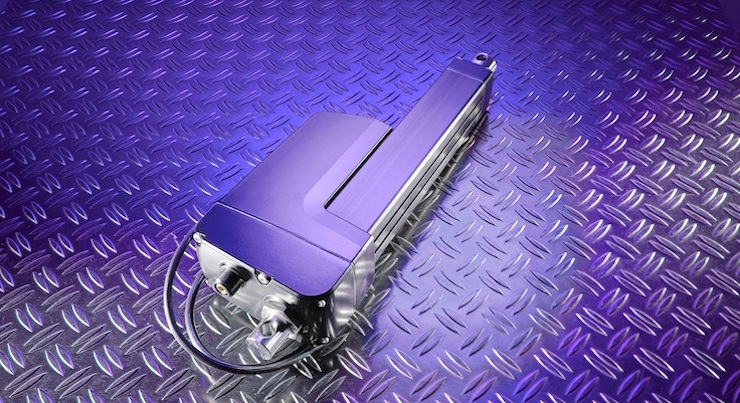

In addition to resistance against environmental hazards such as sunlight UV, Thomson Electrak LL high-duty-cycle electric actuators now offer more electronic control options.
