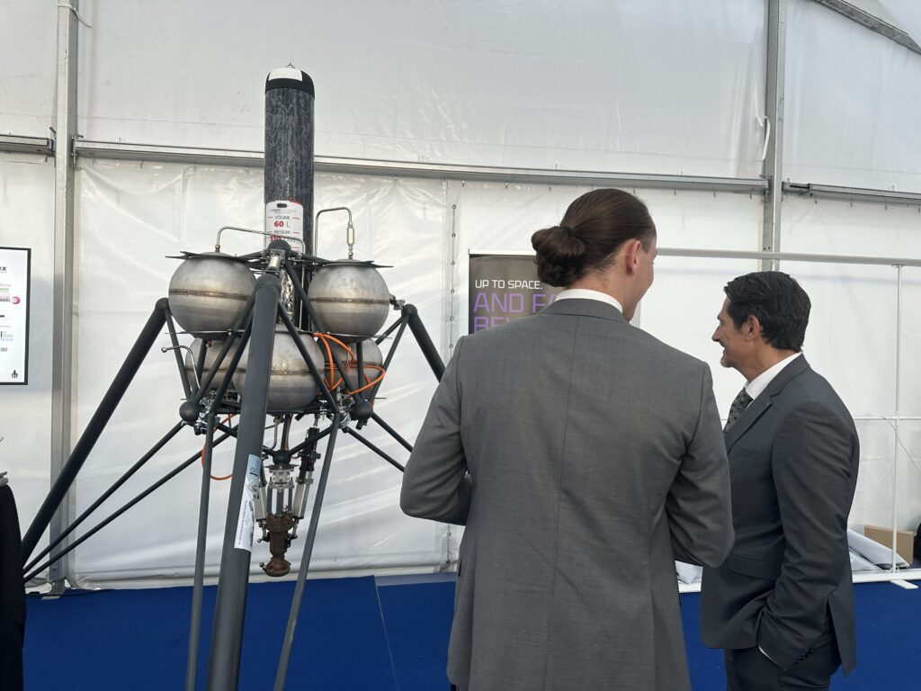

More specifically, in the Elara rocket, the actuators allow engine gimbaling for controlled movement within a narrow ±5° operating range. The PC Series actuators were selected for their compact design, ballscrew-based construction, and accurate and repeatable motion in space-constrained applications.
“Every commanded movement [in rocket-control applications] must be predictable, measurable and easy to verify,” said Regal Rexnord’s Linear Motion Division business development manager Anders Karlsson. “For us, the value of this partnership is supplying components and helping Elara build confidence in the actuation approach before the system moves into flight use. Working closely with the team helped us ensure the motion package fits cleanly within the overall engine control architecture.”
In the Elara rocket, linear actuators allow controlled engine gimbaling.
The actuators were supplied as individual components so the Elara Aerospace team had flexibility in system design and testing. The motion system is currently being validated on development platforms for use in the rocket’s engine control system.
