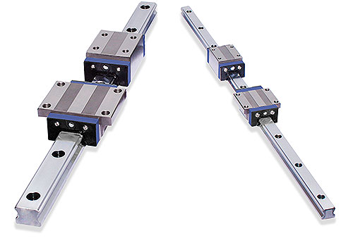

Thomson introduces 400 Series Profile Rail Linear Guides.  The 400 Series is available in 4 meter lengths, in sizes from 15 – 45 mm in 5 mm increments, for extended joint-free rail transfer, even in smaller-sized applications. Double-faced ball track bearing arrangements allow for compliance to simplify installation, and enable equal load carrying capacity in all directions. The 400 Series is available with standard or ball cage carriages that use the same rail design.
400 Series Profile Rail Linear Guides are rated to handle loads ranging from 9800 N up to 129,500 N. They feature a polymer ball-return tube that reduces noise while retaining lubrication. The ball cage option includes individual ball lubricant reservoirs to increase running smoothness and operating life, while reducing noise by up to 30% when compared with standard carriages, even at high speeds.
400 Series Profile Rail Linear Guides are an ideal linear motion solution for uncomplicated factory and laboratory automation, packaging, food and beverage, life science and certain medical applications. With an industry standard envelope and hole patterns, they are completely interchangeable with other profile rail systems and are well-suited as a drop-in replacement. And for higher precision mounting and more compliant system requirements in machine tool, forming, and many other applications with demanding linear motion requirements, the company’s time-tested and field-proven 500 Series Profile Rail Linear Guides are an ideal solution.
