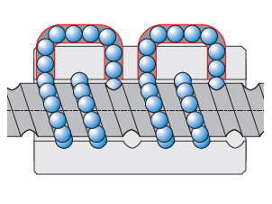

External Recirculation
External ball return involves one or multiple tubes which are located outside the diameter of the ball nut. Pickup fingers guide the balls into the tube(s) to be circulated back to the starting point. When one return tube is used, it spans all the ball tracks, from one end of the ball nut to the other. The more common design, however, uses multiple tubes, each of which spans 1.5 to 3.5 ball tracks.
The external return tube design is easy to assemble, making it well suited to mass production and generally a lower-cost option than other recirculation methods. It is also suitable for a wide range of shaft diameters and leads. However, the physical size of a ball nut with external return tubes tends to be large, so the available space and mounting options within the assembly should be carefully considered when using a ball nut of this design.
Ball Nut Recirculation
External Recirculation via Tubes
Image credit: Bosch Rexroth. Used with permission.

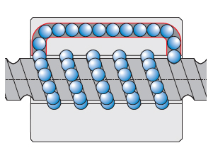

Internal Recirculation
When the balls remain contained within the nut housing during recirculation, this is considered internal ball recirculation. There are two primary methods to achieve internal recirculation—using deflectors or using end caps.
With recirculation via deflectors, balls are lifted across the diameter of the ball screw and guided to the adjacent ball track. This design features one deflector per ball circuit, which makes it especially suitable for ball screw assemblies with small leads. It also yields a very compact ball nut for applications where space is a primary consideration.
Internal Recirculation via Deflectors
