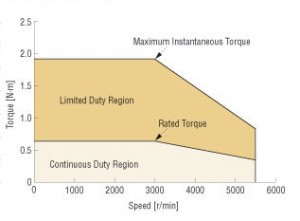

Torque
Taken together with speed, torque is probably the most vital factor in servo motor sizing. There are three components of torque that are important: torque due to acceleration, torque due to the load, and torque due to friction. Based on these components, two calculations can be made: maximum torque and RMS (Root Mean Square) torque. These are compared to the motor’s torque-speed curve, which shows the motor’s continuous and intermittent operating zones.
Torque Speed Curve
The torque-speed curve shows the motor’s continuous and intermittent (limited) operating zones.
Image credit Oriental Motor U.S.A. Corp.
Maximum, or peak, torque typically occurs during acceleration and contains all three components—acceleration, load, and friction. This is also where the iterative nature of motor sizing comes into play, as the acceleration torque is based on the total inertia of the system, including the motor inertia. But since the motor is unknown, a preliminary selection must be made and its inertia factored into the torque equation. Max torque may fall into the intermittent operating zone, since it is required for only a short period of time.
RMS torque is the time-weighted average of the different torque values needed over the full duty cycle, including any dwell time. The required RMS torque should fall within the motor’s continuous operating zone to ensure the motor doesn’t experience overheating.
RMS Torque Equation
RMS Torque is the time-weighted average of torques required over the full duty cycle.
