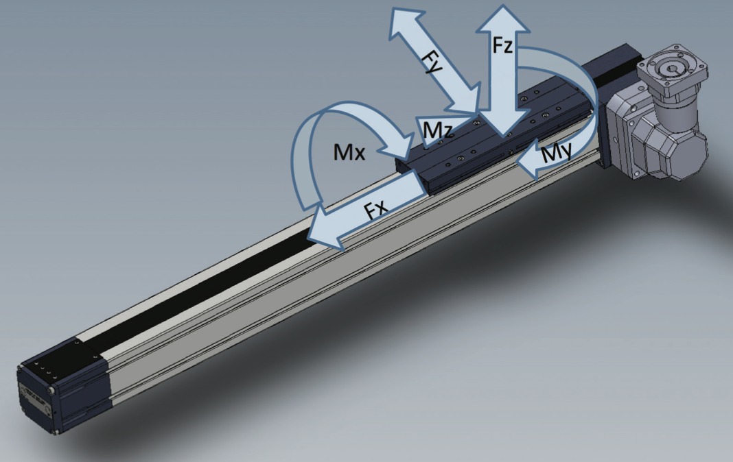

Here, the question of “What” refers to the type of load being moved — its mass, shape, and size. Also define where and how the load is oriented relative to the linear motion system, and whether any of these parameters changes significantly during the process.
Image credit: Rollon
Keep in mind that some applications also include axial (pressing) loads, and these need to be considered during the sizing and selection of drive components. And if the load orientation is vertical or inclined, special circumstances need to be taken into account, such as buckling forces on the drive mechanism and the potential for the load to back drive (or worse, for the load to “drop”) if power is lost.

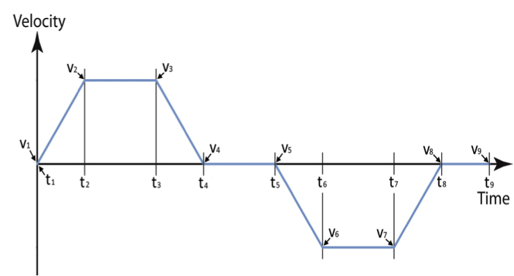

“How fast” refers to the move profile of the stroke. The goal might be to move the load to the target position as quickly as possible, but most applications have specific requirements for traveling at constant velocity during part of the move, for dwell time, or even for maximum speed or acceleration due to the nature of the load or safety concerns. The move profile will also determine the required torque and speed from the motor and whether the application requires a gear reducer.
Image credit: Varedan Technologies
When defining the move profile, the duty cycle should also be defined. In other words, how often will the move be made — how many times per minute, hour, or day? The duty cycle affects not only the life of moving components, it also affects the amount of heating the motor will experience during operation and can have a significant influence on motor selection.
