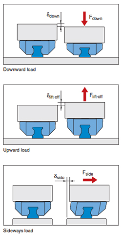

3. Higher rigidity
The line contact formed by rollers also provides higher rigidity than the point contact formed by balls, which is the primary reason that roller rail guides are so widely adopted in machine tools. However, Jason Winburn, Application Engineer at Bosch Rexroth, points out that printing processes that involve pressing, such as flexographic printing and narrow web printing, also benefit from the rigidity of roller rail guides. Less deflection of the guide block means less deflection of the printing head, resulting in a higher quality print.

Linear bearing deflection
Deflection can be caused by downward, upward, or sideways forces. Photo courtesy Bosch Rexroth
