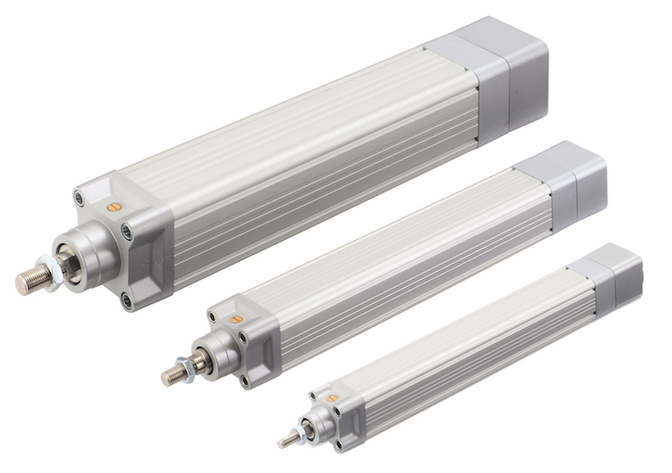

AVENTICS Series SPRA electric rod-style linear actuators offer enhanced load capacity, accuracy, and reliability that helps to maximize productivity. (Image courtesy of Emerson)

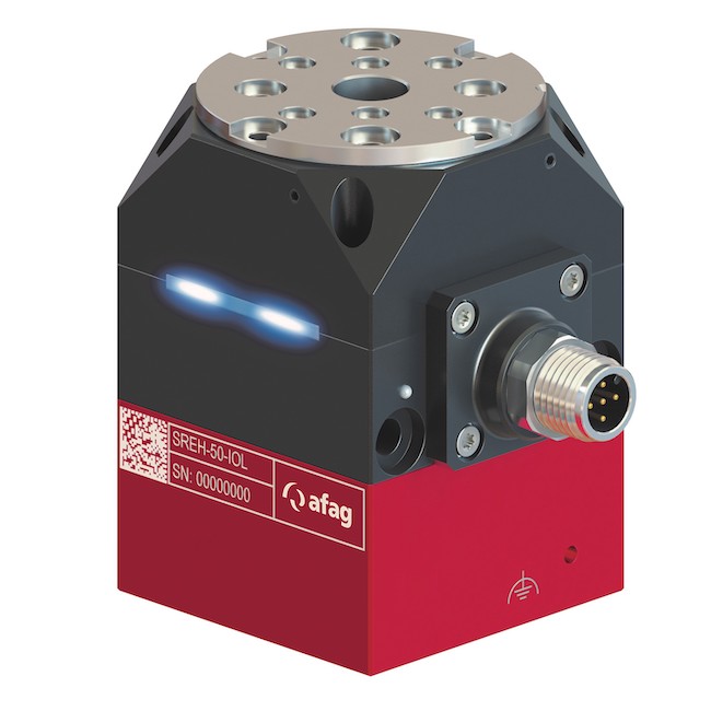

An example of a smart rotary module is the AVENTICS SREH-50-IOL. A compact electric linear actuator, it features an integrated controller and planetary gearbox for more sophisticated motion profiles. (Image courtesy of Emerson)
