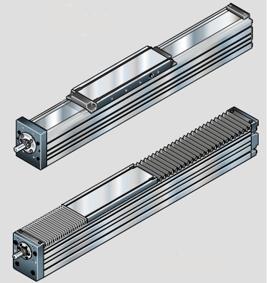

In some cases, protecting the actuator from contamination, especially liquids and large debris, can be achieved by mounting the unit upside down or on its side, without any additional hardware. But when airborne particles or fine dust are present, a secure cover is the best way to protect internal components.
The original covering method for linear actuators was to install accordian-style bellows, typically made of polyurethane. But bellows can add nearly 20 percent to the length of the actuator, making them less than ideal for applications with limited space. An alternative solution is to use a stationary cover strip, made of either rubber or stainless steel.
Screw driven actuators with sealing strip (top) and bellows (bottom)
Unlike bellows, stationary cover strips require only a small amount of additional space – typically 150mm or less – to account for hardware to clamp the strip at its ends and to guide it through the bearing table.  And because they mount flush with the top of the extrusion or body of the actuator, sealing strips don’t add to the width or height, and they provide excellent sealing characteristics.
