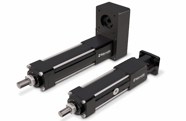

Tolomatic’s new RSX press model (RSX096P) electric linear actuator increases the force range of the existing RSX product family to 40,000 lbf (178 kN) and is designed to be optimized for force in the extend direction. The RSX press-model electric actuator is ideal for metal-forming and assembly including pressing, punching, stamping, riveting, fastening and joining.
The existing RSX080 (18,000 lbf / 80 kN) and RSX096 (30,000 lbf / 133.4 kN) electric linear actuators meet the need for many extreme-force push/pull applications traditionally done with hydraulic cylinders. The entire RSX family is designed and tested for high duty-cycle applications. The actuator’s planetary roller screw provides reliable operation and long, consistent life.
linear actuator
“Adding the press model to the RSX extreme-force electric actuator family allows machine designers to utilize an actuator platform optimized for high-force, industry-specific applications,” said Daniel Schmit, product manager, Tolomatic. “Many assembly applications in the metal-working, automotive and other heavy industry require high forces over a localized area, such as pressing, joining, riveting and many others.”
The RSX096P press model is upgraded with larger tie-rods and an optimized bearing system, as well as a high-strength front-mounting flange. The entire RSX actuator family’s heavy-duty construction includes tie-rods and Type III hard-coat anodized aluminum or zinc-plated steel. A standard anti-rotate feature prevents the rod from rotating without external guidance. Rated IP67, the actuator resists ingress from splashing water and dusty environments. An extended temperature range option is designed for outdoor applications.
Tolomatic’s “Your Motor Here” feature allows for servomotors and gearboxes up to 215-mm frame size. Additional features include an access port for re-lubrication to maximize service life and a breather/purge port to prevent ingress into the actuator. RSX actuators are built-to-order with configurable strokes, flexible mounting options and shipped with industry-leading delivery.
